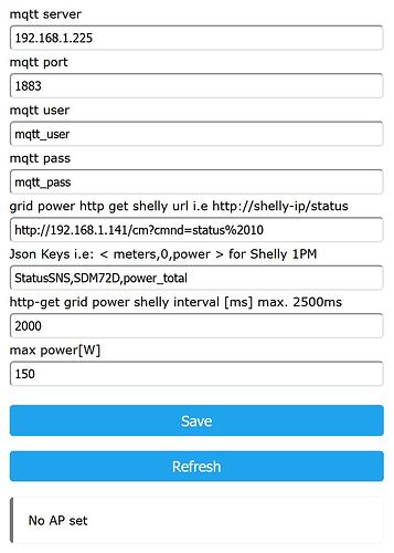

* After the first start (~30s) you will find an open accesspoint named:"Trucki2Shelly Gateway".
* Connect to it and open http://192.168.4.1 in your browser. Select Configuration and set your
* wifi credentials, static IP, Subnet,Gateway address for this ESP8266 Wemos module, the Shelly
* IP address, the maximum power of the solar inverter and mqtt server, user and password if you
* want to publish mqtt data.Use json_keys: < total_power > for a Shelly 3EM and < meters,0,power >
* for a Shelly 1PM. You can even use a Tasmota instead a Shelly by modifing the
* shelly url (default: http://< shelly-ip >/status) and json_keys.
* Use 0.0.0.0 for static IP, subnet and getway if you want to get an
* IP address from your DHCP server.

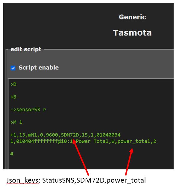

* Tasmota's SML scripting tool is very powerful and supports many smartmeters (IR,Modbus,...):
* https://tasmota.github.io/docs/Smart-Meter-Interface/#meter-definition
* By changing shelly_url and json_keys of the Trucki2Shelly Gateway you can import Tasmota
* grid power (shelly_power) for the ZeroExportController from your Tasmota.
* The shelly_url for your Tasmota should look like this:
* http://<tasmota-ip>/cm?cmnd=status%2010 .
* The json_keys are dependend on your Tasmota script configuration. The first json key is
* StatusSNS . If your Tasmota SML script i.e. looks like this:
* >D
* >B
* =>sensor53 r
* tper=20
* >M 1
* +1,13,o,0,300,SML,15,32,2F3F210D0A,063030300D0A
* 1,1.8.1
00(@1),Power_curr,W,Power_curr,2
* Your second json_key is SML and your third json_key is Power_curr .
* So, on the Trucki2Shelly Configuration page you have to enter for the
* json_keys: StatusSNS,SML,Power_curr

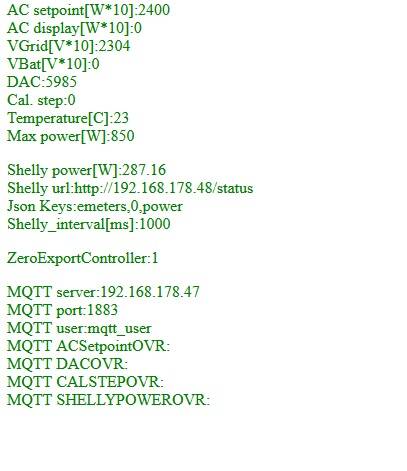

* Webserver
* Enter the static IP address of the module in your browser and you will get a very basic
* webserver with all values. The website will autoreload every 2s.

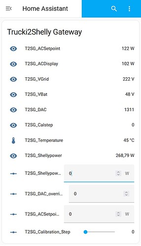

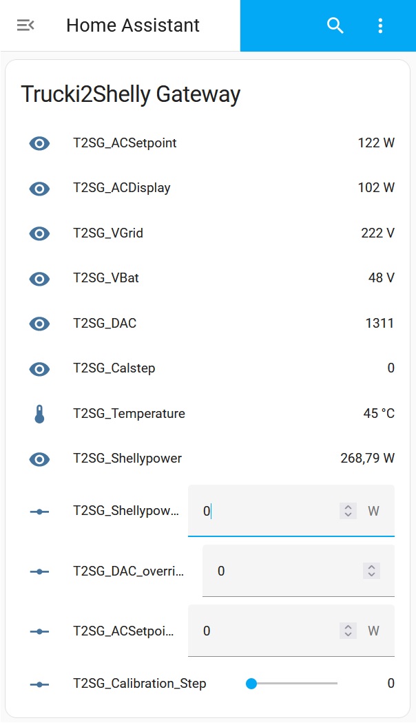

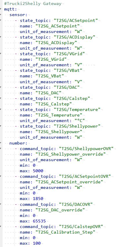

* MQTT client publish (read only)
* The mqtt client publishes every 1.3s the following topics: T2SG/ACSetpoint, T2SG/ACDisplay,
* T2SG/VGrid, T2SG/VBat, T2SG/DAC, T2SG/Calstep, T2SG/Temperature, T2SG/Shellypower.
* You can use the MQTT client featurevto log data i.e. with HomeAssistant.

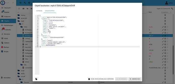

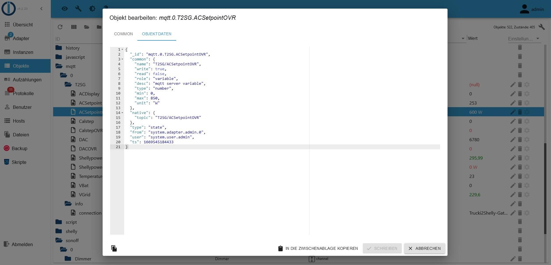

* MQTT client subscribe (write only)
* By writing to the mqtt topics: T2SG/ACSetpointOVR [W],
* T2SG/CalstepOVR [1:start calib., 99:default LUT], T2SG/DACOVR [0-65535], you can overwrite
* the current values. The ZeroExportController will be disabled.
* The ZeroExportController will be enabled again if you write to T2SG/ShellypowerOVR [W].
* You can use T2SG/ShellypowerOVR to feed the ZeroExportController instead of the Shelly.

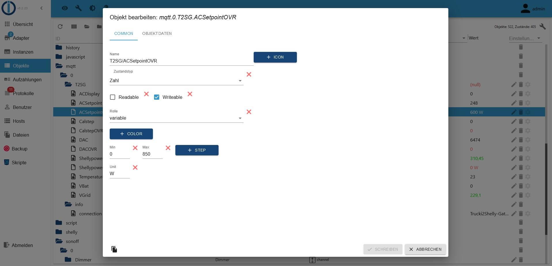

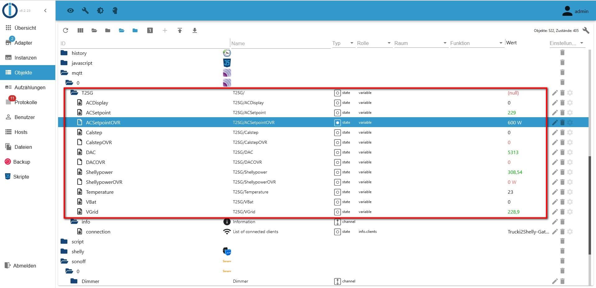

Trucki2Shelly Gateway V1.02 mit Tasmota und MQTT subscribe/write support ist online:
https://github.com/trucki-eu/Trucki2Shelly-Gateway
Hallo Trucki,
bei mir funktioniert nur deine ModBus Tasmota version. Ob ich jetzt deine neue Trucki2Shelly oder EspHome version nehme starten sobald sie auf deiner Platine sind nicht mehr.
Wenn ich die Wemos über USB mit Strom versorge geht es ohne Problem.
Ich habe auch meine zweite Platine mal ausprobiert ist das gleiche.
Und einen anderen Wemos habe ich auch schon ausprobiert.
Es startet keine andere Version als die Tasmota Modbus version kann die Sun auch damit steuern aber eine integration in iobroker nicht so toll umzusetzten.
Hast du vielleicht eine ahnung woran das liegen kann?

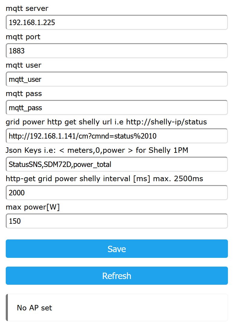

Hi Trucki,
ich habe T2S.bin auf mein Wemos geflasht. In der WiFi configuration habe StaticIP,Gateway und Subnet leer gelassen, damit IP von meinem Router zugeordnet wird. Das ist auch passiert, Wemos ist in meinem Wlan eingebunden, ich sehe es als "tasmota-xxxxxx-modbus". So weit alles gut.
Aber wenn ich die IP im Browser eingebe, wird keine Verbindung mit dem Wemos stattfinden. Keine Weboberfläche, wo die aktuelle Werte angezeigt werden sollten.
Wemos blinkt cca 11-13 mal dann pause, dann wieder blinkt .. unregelmäßig.
Ich muss noch dazu sagen, den Wemos habe ich noh nicht mit deiner PLatine verbunden. Wemos ist getrennt von allem.
Ist das normal, das ich mich nicht durch IP mit dem Wemos verbinden kann? Muss Wemos mit zuerst zu deiner Platine angeschlossen werden?

... Trucki2ShellyGateway läuft jetz ... vielen dank an Trucki dafür. Ich habe noch keine richtige MQTT Verbindung zu ioBroker. Könnte mir jemand damit helfen, gerne auch per PN?
In Sonoff Adapter taucht die Trucki2ShellyGateway, in den Objekten habe ich aber nur die Temperatur. Keine weitere Objekte wie ACsetpoint, ACdisplay, DAC ... Könnte jemand genauer beschreiben, wie soll ich diese Objekte "erschaffen"?

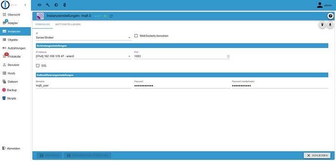

Eine Seite zurück hat User @centz beschrieben, dass man mit hilfe des Programms MQTT.fx diese "Werte" zuerst senden muss. Das klappt leider nicht bei mir ... ich kapiere das wahrscheinlich nicht ganz ... und hier bei Trucki2ShellyGateway ist das wieder etwas anders als bei Modbus-Tasmota...
EDIT: etwas habe ich entdeckt ... der Sonof Adapter ist das Problem. Jetzt mit MQTT Adapter habe ich zumindest die Info-Werte (read only). Die drei write only Werte (z.B. ACSetpointOVR) habe ich zwar manuell hinzugefügt, aber wenn ich z.B. ACSetpointOVR auf ein Wert manuell setze (z.B. 150), übernimmt das die T2SG nicht ... da bräuchte ich noch einen Tipp.
@Pali: schau mal in das Log File von deinem mqtt broker. Oft findet man dort den Grund.
... die MQTT Verbindung im ioBroker läuft jetzt auch, mit kleinem Problemchen:
der Sonoff Adapter war das Problem. Jetzt mit MQTT Adapter habe ich die Info-Werte (read only) und werden auch regelmäßig aktualisiert. Die 4 write only Werte (z.B. ACSetpointOVR) habe ich zwar manuell hinzugefügt, aber wenn ich z.B. ACSetpointOVR auf einen Wert manuell setze (z.B. 150), übernimmt das die T2SG nicht, der ZeroExportController wird nicht deaktiviert, läuft weiter und regelt den SUN1000.
... da bräuchte ich noch einen Tipp, wie diese Werte richtig setzen, damit diese von T2SG übernommen werden.
Anbei Screenshots von verschieden MQTT- und Objekt-Eigenschaften und Einstellungen. Vielleicht entdeckt jemand, wo der Fehler liegt.
Vielen dank im Voraus dafür.
Hallo Trucki,
hat das mit der Tasmota Bin File geklappt?
Die entsprechenden json strings habe ich dir ja zukommen lassen.
LG, Sven
Hallo Sven,
da stehe ich gerade auf dem Schlauch. Ich habe in Erinnrung, dass Du mir ein JSON Snippet geschickt hast, welches ich mit der neusten T2SG V1.03 erfolgreich getestet habe.
Oder verwechsele ich da gerade Namen, Nicknames, etc... Sorry es ist schwer geworden den Überblick zu behalten.
Gruß,
Trucki
