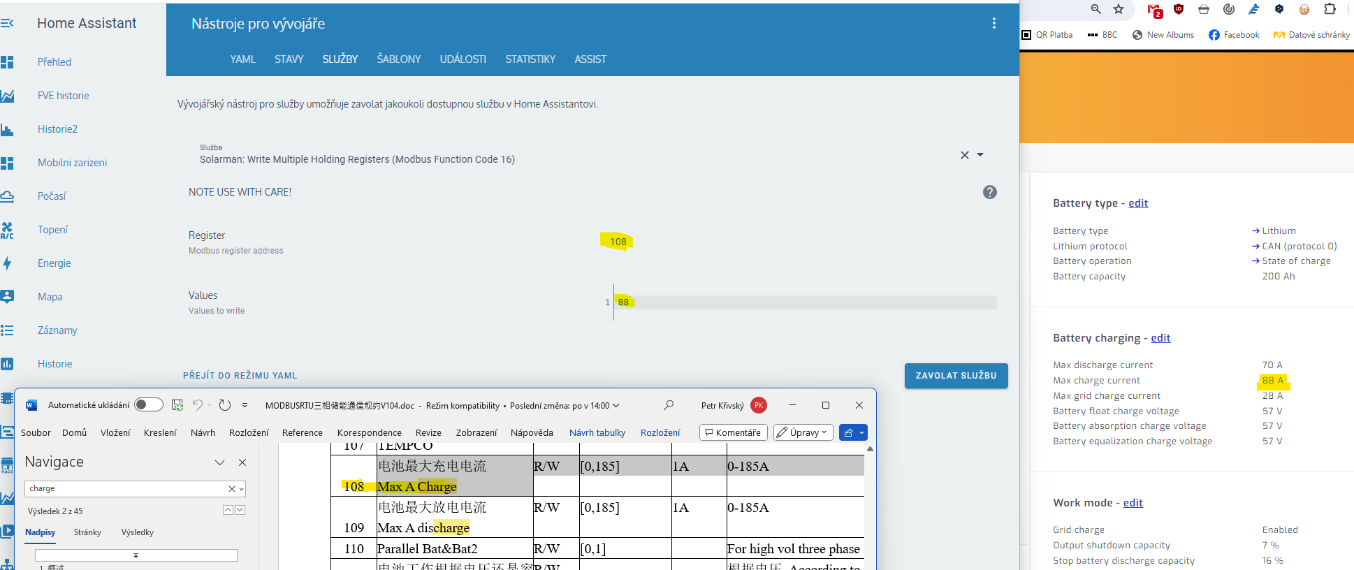

@higgy Hey, its is possible to use Home Assistant and Solarman dongle with GitHub - StephanJoubert/home_assistant_solarman: Home Assistant component for Solarman collectors used with a variety of inverters. integration. For few months it has function for service calls which can write to Modbus registers - home_assistant_solarman/advanced.md at main · StephanJoubert/home_assistant_solarman · GitHub
On picture change charging current to 88A. Service calls can be automated of course.
DeepL translation: Hey, it is possible to use Home Assistant and Solarman dongle with GitHub - StephanJoubert/home_assistant_solarman: Home Assistant component for Solarman collectors used with a variety of inverters. integration. For a few months now there has been a function for service calls that can write to Modbus registers - home_assistant_solarman/advanced.md at main · StephanJoubert/home_assistant_solarman · GitHub.
In the picture the charging current changes to 88A. Service calls can of course be automated.

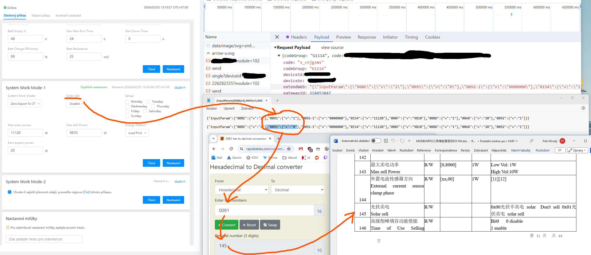

EDIT: Help for searching for Modbus values to double check that you change what you want and not destroing your inverter.
@k3ivi Hey, how you starting solarman on PC to check jsons? Android emulation? Do you also see reading register for other stuff, like BMS information or battery?
@eugenius ganz normale Webseite je nach Account https://home.solarmanpv.com bzw. https://globalpro.solarmanpv.com/ dann unter Devices den Inverter auswählen und dann remote control bzw. device control.
