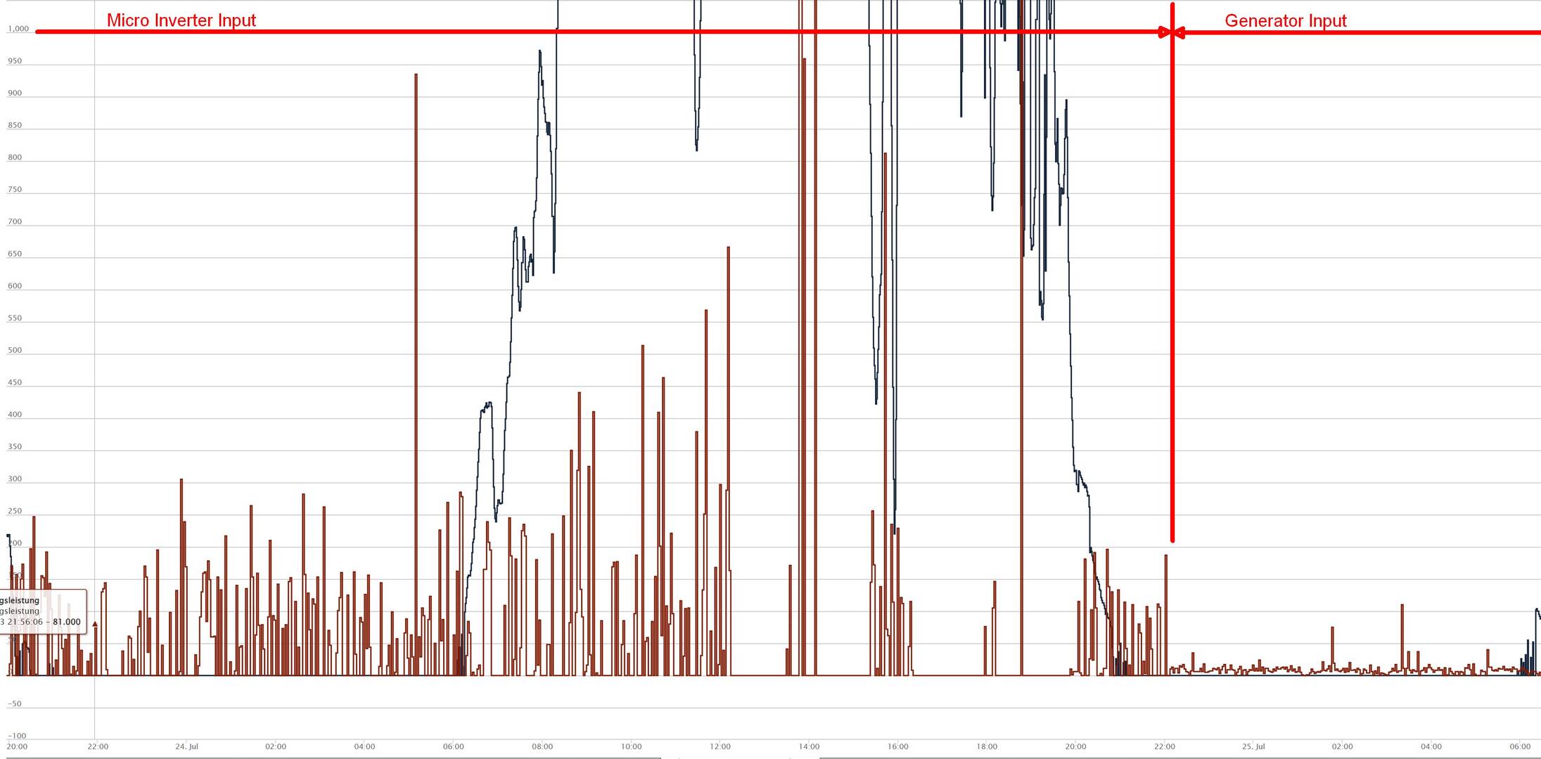

Vor meinem Urlaub hatte ich am 31.07.2023 einige Punkte beim Deye Support angefragt.
Am 18.8.2023 schrieb mir der Deye-Support, dass die Punkte 2 und 3 durch ein Update gefixt werden können.
Demnach wurde in Version 1139 zumindest die Regelung verbessert und das unsinnige Entladen der Batterie behoben.
Bisher habe ich das Update allerdings noch nicht ausgeführt und dies überprüft.
Detailliert waren die Punkte:
2. I had got a PV inverter already connected to Deye GRID and don't use the PV capability of the Deye inverter, but use it with a battery. Selected is mode "Zero export to CT", which should avoid buying energy from the grid. When the battery is full, I need no further charging and may therefore switch the GEN from "Micro Inverter Input" to "Generator Input". Using this setting the control quality is really fine. But to load the battery, I must switch the GEN to "Micro Inverter Input". Using this setting, the control quality is really bad and as a result about 6 times the amount of energy need to be bought per day from the grid as with the "Generator Input" setting. You can see the comparison of the two modes in the added control_quality.jpg. Displayed in brown is directly the instantaneous power from the energy counter, which ideally should be zero, which nearly holds true on the right side with "Generator Input". I am a control engineer by myself and know that sensor, actuator, process and control parameters may influence the control quality. - The CT sensors are the same with both settings and can not be the reason. - The actuator is the main function of the Deye inverter influencing the phase currents, which flow in and out of the GRID connection. This is also the same with both settings and can not be the reason. - When switching between the two modes, one can hear a relay clicking. So one may think, the process is changing. But e.g. at night, when the battery is discharging, the process is independent of the setting exactly the same, so the process can't be the reason either. - So there must be a change of the controller as the reason for that miserable control quality. Maybe the control parameters are switched with the setting or the gain of the control path is changing and the control parameters are not adapted to this. I know that a lot of users are very unsatisfied with this control quality. Potential buyers hesitate to buy a Deye inverter, because of this. So it is in Your own interest, to eliminate this bug as far as possible. 3. When the battery is fully loaded and there is plenty of power from the "Micro Inverter Input", one would expect, that the battery holds its SOC. But instead the battery immediately starts to discharge, when it is fully loaded. You can see the discharge in the added diagram Unneeded_Battery_Power.jpg in which the battery power is higher than the zero line of the "Total Solar Power", even if the "Total MI Power" is very high. In setting "Micro Inverter Input" it is discharged with nearly 1.5 A minimum. In setting "Generator Input" it is discharged with nearly 0.65 A minimum. Of course the discharge is higher, when the power is needed for the LOAD, but when sufficient power comes from the Micro Inverter, then no discharge should happen. The discharge reduces the efficiency of the system, because more power is needed to load the battery again, than you get from it when discharging. Additionally the battery life is reduced because of the unnecessary discharging. Many users are aware of that unneeded discharging and are unsatisfied with it also. So it would be great if You could solve these problems soon.

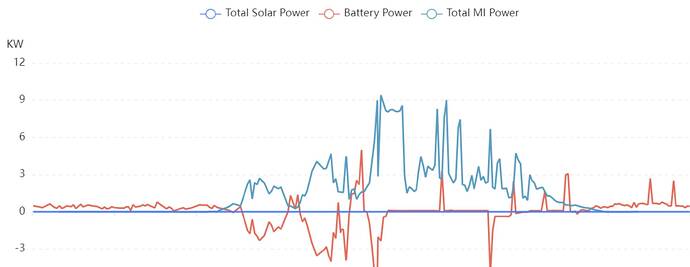

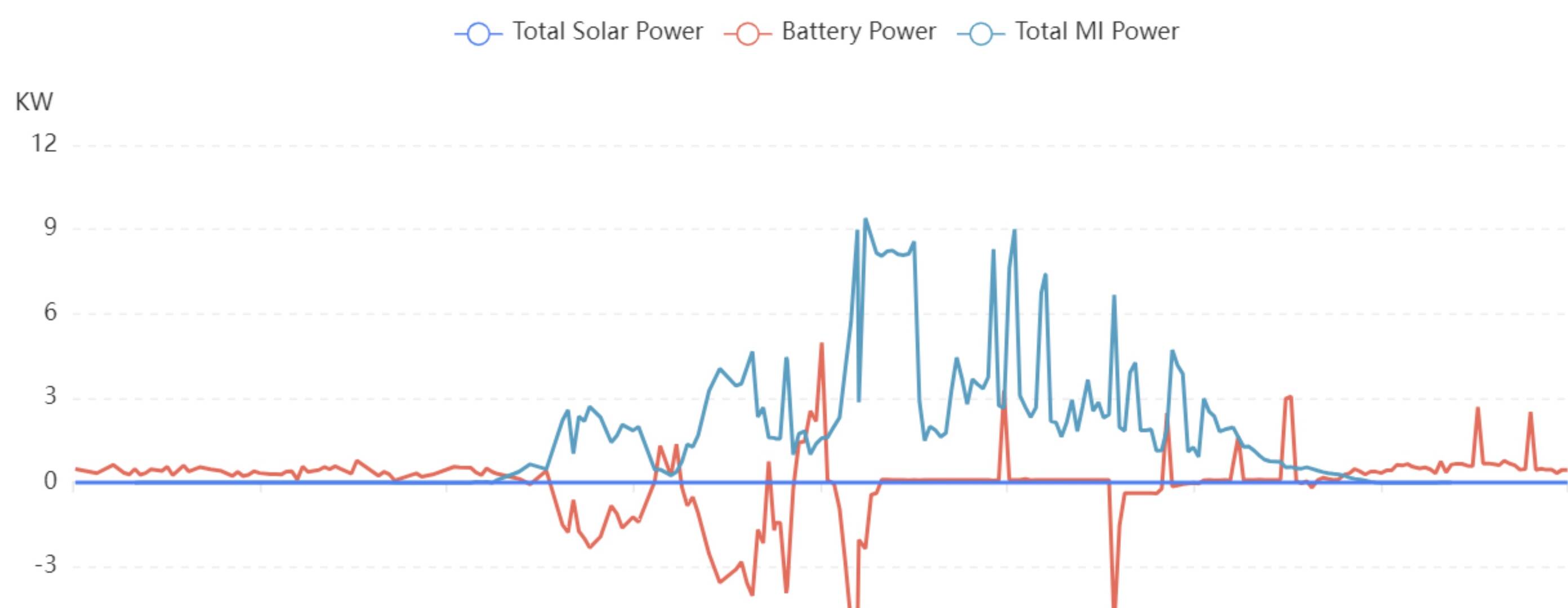

Ich geb der 1139 noch einen Tag aber bisher ist die Regelung (mit aktiven MI) ziemlich mies und schlechter als mit der 1135. Man kann mit der 1139 auch keinen Wert mehr unter 20 eingeben. So wirklich nach Verbesserung sieht das nicht aus und ich habe auch so den Eindruck, daß das Deye nicht wirklich interessant, da sich anscheinend nur deutsche Nutzer darüber beschweren.

Mich stört es auch nicht... Die paar kwh... Und wenns der Hardware zum längeren Leben verhilft, zahl ich das gern.
Hab pro Monat 4kwh.ich finde das super. Dieses Gebastel mit mi invertern haben wahrscheinlich auch nur wir ?

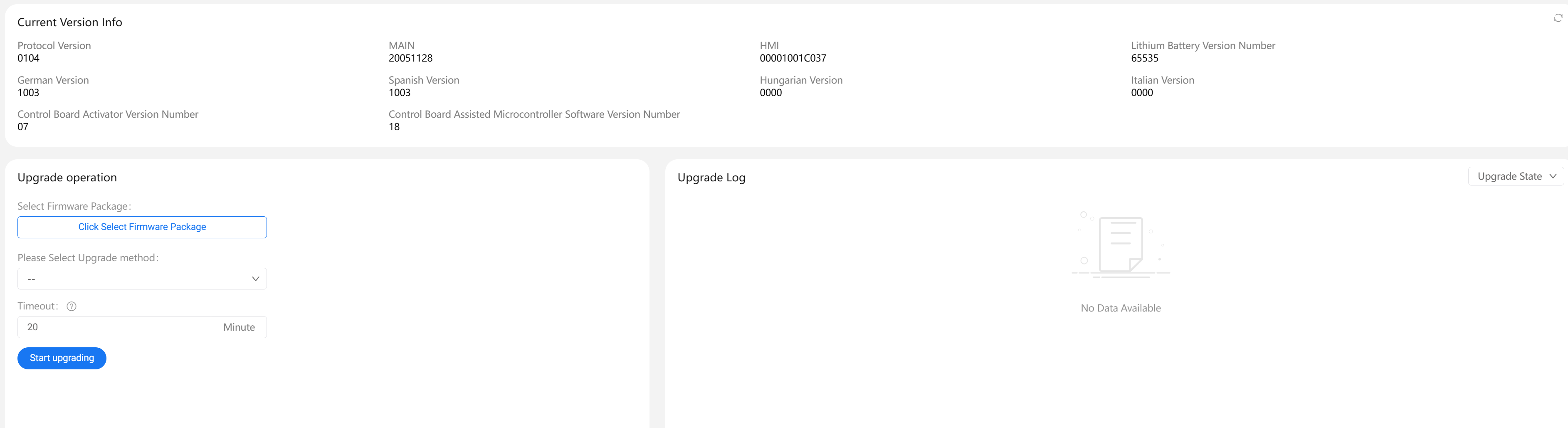

Hat schon mal jemand versucht über das Webinterface ein Update zu machen, das sieht zumindest sehr einfach aus, habe es aber noch nicht versucht.
Mit Webinterface meine ich die Deye Cloud, sieht dann so aus .
Mein Deye 12K hatte bei Lieferung HMI-Firmware Ver 1001-C031 und Main-Firmware Ver 2005-1128-1807.
Nun habe ich manuell auf Ver 1001-C037 bzw. Ver 2005-1139-0814 aktualisiert, weil der Deye-Service sich dafür zu lange Zeit ließ.

Danke für die Anleitung. Stimmt es, dass wie im ersten Beitrag geschrieben Version 1131 im März vor Version 1128 im April kam, oder kam sie vielleicht im Mai?
Hab da mal ne frage?
Der Deye 12k ist nicht an der Batterie angeschlossen, und er macht das firmware update nicht, nur das inverter update, das ging, da war der download Ballken da.
Hat da einer ne Idee??
