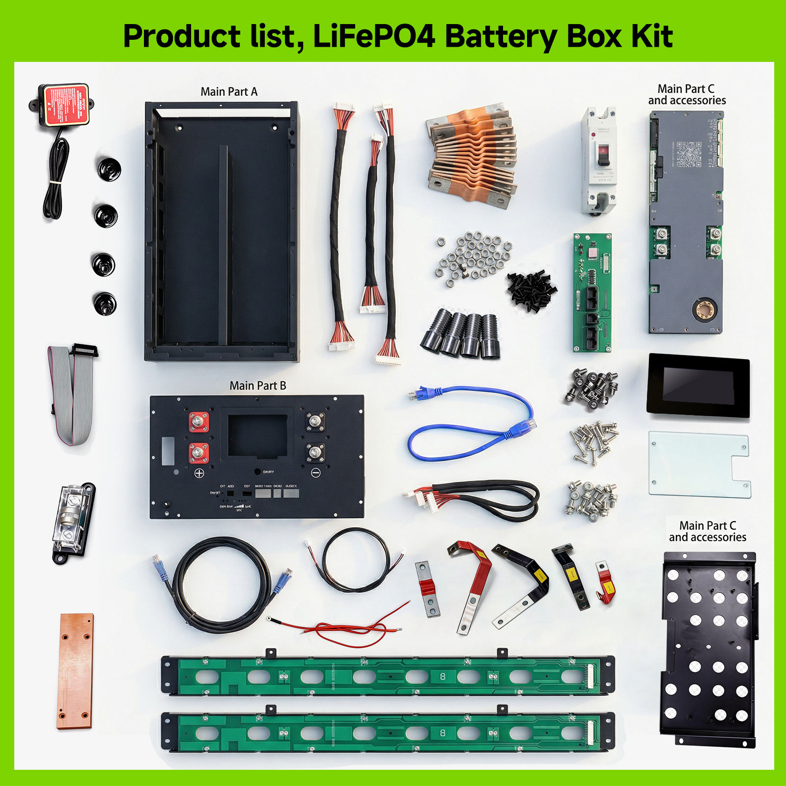

DIY 16KWH battery box
We have DIY 16KWH battery box, stackable, work with LF280K, comnicate with Victron inverter https://www.alibaba.com/product-detail/New-Design-Diy-Box-Home-Solar_1601749458174.html?spm=a2756.order-detail-ta.0.0.682c2fc2qIRLtI

Hi Dear!
Thank you for your interesting our 16KWH DIY stacked battery box.
As your serials questions, please check as following response;
  1. Our case can compatible with JK BMS V19 PB2A16S30P, it is no problem! As our standard is 200A, it is customized ship from China to Germnay;
  2. DC breaker, it is 250A, M1-250, 257**80**105mm; And Fuse is 250A;
  3. It is 4.3 inch LCD Screen, If you need 7.0 inch, the front face should be customized.
  4. Sheet metal thickness is 1.8mm with Frosted process;
  5. Our case can suit with 280/302/314/320AH, extra plate with 230AH,But not fit with 100AH,
  6. Yes, we have English version manual for cutomers. But now, it is not available CE certifications
  7. Yes, we can ship them 4 cases from China to Germnay each order. May I have your delivery address?
Thank you!
Best Regards
Ella Lv
