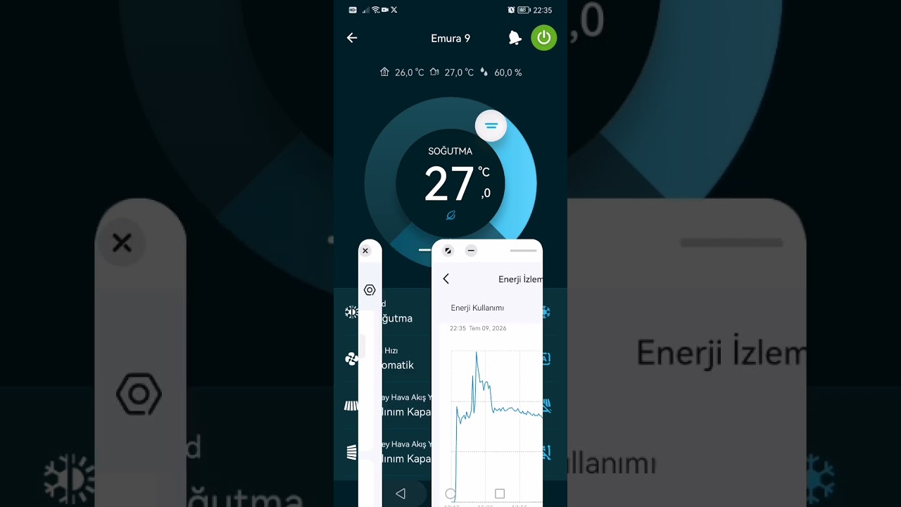

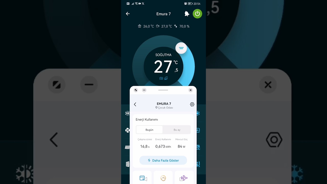

Emura, 9000 BTU and 7000 BTU Cooling Test
