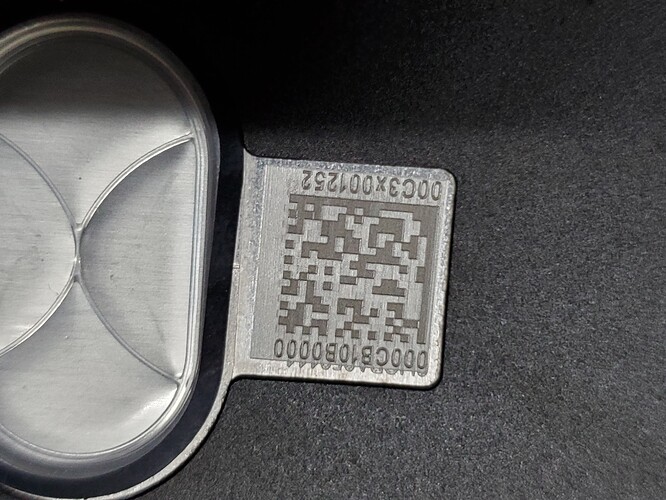

Allerdings sind die Codes wohl nachgearbeitet. Das Handy kann sie nicht mal lesen und bei manueller Eingabe fehlt eine Stelle (23-stellig). Hier mal ein Foto. Man sieht sehr schön den alten Code darunter.
Bestellt hatte ich Hitlium, eine Nebenmarke von EVE.
Was tun? Reklamieren oder gut sein lassen? Ich weiß vom Channel G8N, dass die Hitlium wohl umgelabelte Eve sind. Vom ersten Eindruck scheinen sie gut zu sein.
Ich denke ich werde Mal einen Code freilegen und schauen was dahinter steckt.

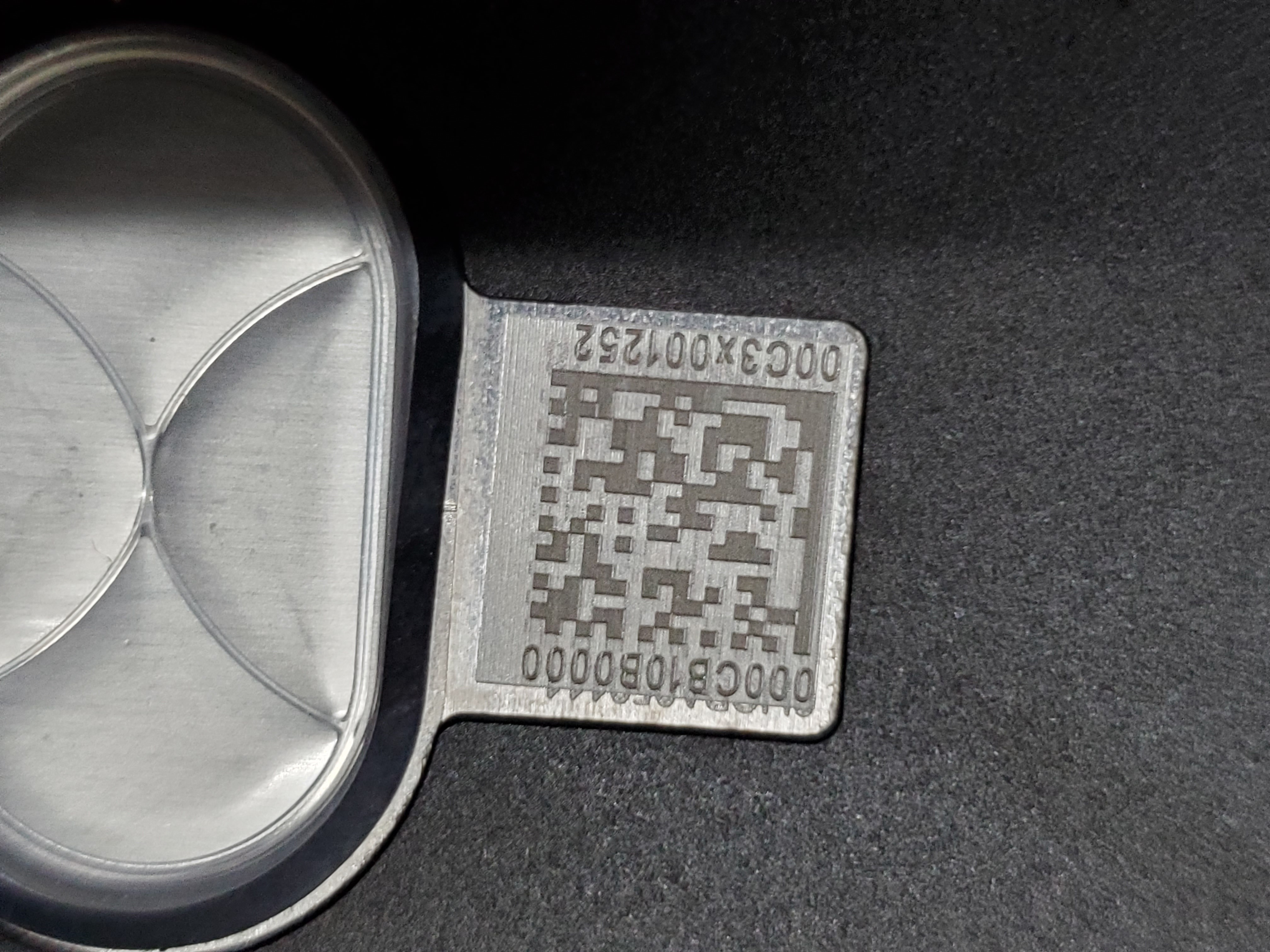

Hallo, mein Kommentar in einem US Forum (btw - wie kann ich hier Bilder hochladen?)
Hi, I had the same experiance:
I ordered 64 of this "Hithium" cells at tewaycell.com and may warn you:
As Example:
  • The serial numbers do not match the usual manufacturers codes nor production information (e.g. manufacturing dates) and nowhere is written Hithium, the cells are just simple blue.
  • All serial numbers start with 000C-B10C-0000 followed by 00C4-*000-0*** e.g. 00C4-G000-0151 and it is clear visible that a different code was erased by overwriting it with laser engraving a new code (see attached pictures) - left side you may recognize the old code!
  • The Voltage is ~3.25 - 3.29V resistance is between 0,21 and 0.23 mΩ. This seems to be quiet high as I expected ≤ 0,18 mΩ as Hithium is partial owned by CATL (joint venture). Also described in "cdn.shopifycdn.net/s/files/1/0603/8283/8841/files/HITHIUM_280Ah_LiFePO4_Cell_Product_Specification.pdf"
  • The size of the cells is according to the webpage of Hithium, with the difference that they have laser welded M5 studs on it.
    According to my information, Hithium is using an "inner thread" instead of bolts.
    With this "trick" they might cover scratches at the terminal to hide a prior usage!
  • Next point, at the picture you see the plastic is slightly melted - normally bolts are welded on prior the plastic cover is mounted at the terminals.
  • Several of the cells are bloated (swollen) a 4 mm expansion at each side!

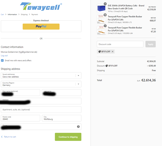

    ich habe bei Tewaycell 16 x EVE 304AH bestellt. Es sollen A Grade Zellen sein, auf der Webseite werben sie mit korreten QR-Code, bin sehr gespannt was sie liefern.
    Ich wollte die Messprotokolle, leider Fehlanzeige, hier die Antwort ! ! !
    We did quality check and test for cells before shipping, but in order to increase efficiency, we don't to recorde each result of cells. Then we select unqualified cells and only keep qualified ones. There is also the possibility of damage or self-discharge during transportation, and the data will be different after receiving.
    Unless the customer has a request for recording in advance, we have no record at present.
