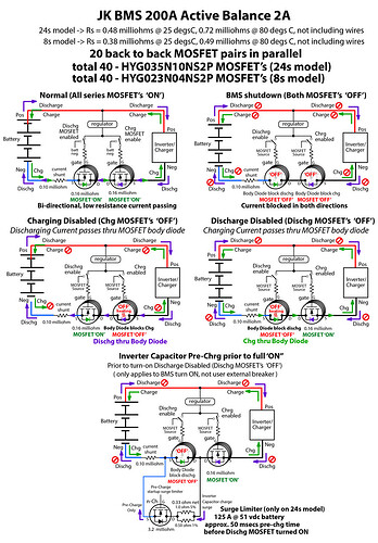

Laut Ali Express gibt es das V19 auch als Precharge Version:
Hier ist der Link aus dem DIY Forum (darf jetzt Links posten…):
https://diysolarforum.com/threads/jk-bms-percharges-inverter.67408/#post-850793

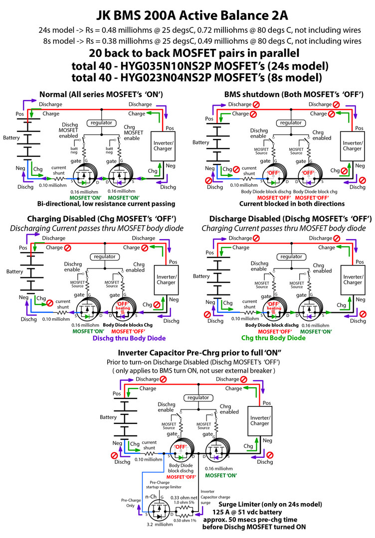

If you look at the bottom diagram, the 16S JK BMS has a pre-charge that limits it start up current to about 125A (for 48vdc system) and takes about 50 milliseconds to charge typical inverter input capacitor.
It only works when the BMS is first activated from an off state. Once BMS is active it provides no surge protection, like if you turn off then on a series DC breaker after inverter discharges its input capacitors.
I guess you found an easy way to get the BMS power up sequence with its pre-charge circuit to operate.
The 8S model does not have this separate pre-charge circuit. There are places on the 8S PCB for the extra MOSFET and resistors but they are not populated on PCB. Guess they discovered the 8S battery voltage is not enough to damage the MOSFET's so they can do without it on the 8S model. There is some soft start, with a lot of tolerance variability, in just turn on time for the regular high current series MOSFET's.
In dem Bild steht aber das nur die 24s Modelle den Softstrart machen, wenn das so stimmt wären die PB Modelle mit 16S nicht dabei…
