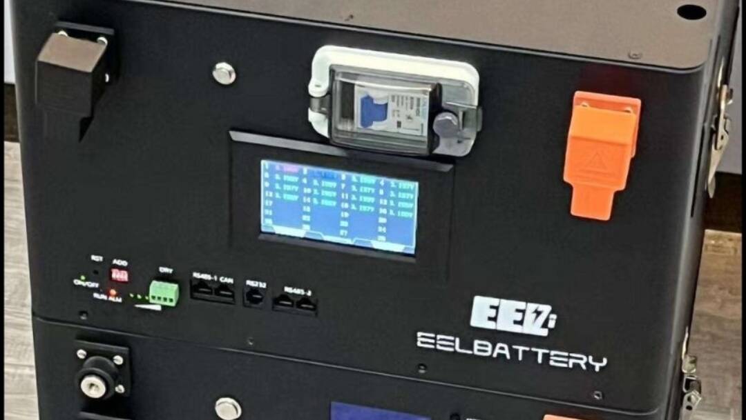

Habe von eel vorab das folgende Bild bekommen:
Kostenpunkt für 10 Stück ohne Zellen:
10 pcs Stackable Box with 200A BMS+display
$409*10+$841=$4931(DDP fees by sea)
Wer hätte Interesse an einer Sammelbestellung?

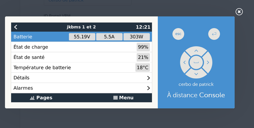

hello everyone since update 15.17 in jkbms I find myself having the bms that gives me 21% health status while I had 100% where does this percentage come from and how is it calculated thanks friends!!!
