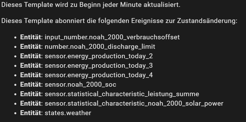

Ergänzung, warum ist die ganze Berechnung in einem Template Sensor? --> Ganz einfach weil so der Code im Template Editor viel leichter zu testen ist, wie in einer Automation
Sensor ohne Erklärung!!
{% set h = now().hour %}
{% set m = now().month %}
{% set wr_max = 500 %}
{% set wr_min = 75 %}
{## weather factor calculate ##}
{%- set ns = namespace() %}
{%- set ns.forecast_factor = 1 %}
{% for state in states.weather %}
  {% if state.state == "partlycloudy" %} {% set ns.forecast_factor = 0.8 %}
  {% elif state.state == "sunny" %} {% set ns.forecast_factor = 0.9 %}
  {% else %} {% set ns.forecast_factor = 0.6 %}
  {%- endif %}
{%- endfor %}
{% set forecast_factor = ns.forecast_factor %}
{## location factor calculate shadow, clouds add fog not in the wheater forecast ##}
{% if( m >= 11 or m <=2) and (h <= 10 or h >= 15) %} {% set location_factor = 0.15 %} {% else %} {% set location_factor = 0 %} {% endif %}
{% set forecast_factor = (forecast_factor - location_factor) | round(2, 'ceil') %}
{## solar forcast with forecast_factor, normally solar forecast is up to *2 to high on my location ##}
{% set forecast = ((float(states('sensor.energy_production_today_2'),default=0) + float(states('sensor.energy_production_today_3'),default=0) + float(states('sensor.energy_production_today_4'),default=0)) * forecast_factor) | round(1) %}
{% set soc = int(states('sensor.noah_2000_soc'),default=15) %}
{% set socR = soc - int(states('number.noah_2000_discharge_limit'),default=15) %}
{% set pvp = int(states('sensor.statistical_characteristic_noah_2000_solar_power'),default=0) %}
{## "round" the pv power down, reserve for loading the batterie ##}
{% set pvp_calc = int(((pvp - 35) / 50) | round(0, 'floor') * 50) | round(0, 'floor')  %}
{## move the consumption calculation up, thats for losses by the inverter and because i don't have a complete consumption measurement ##}
{% if( m > 11 or m <=2) and (h < 9 or h >= 14) or (soc < 50 and pvp_calc < 650)  %} {% set offset = 50 %} {% else %} {% set offset = 100 %} {% endif %}
{% set consumption = int((int(states('sensor.statistical_characteristic_leistung_summe'),default=150) + 20 | round(0, 'floor')) / 50) | round(0, 'floor')  * 50 + offset %}
{% set consumption_calc = consumption + int(states('input_number.noah_2000_verbrauchsoffset')) | round(0, 'floor') %}
{% set pvpOver = pvp_calc - consumption_calc %}
{% if pvp >= 800 and socR >= 15 %} {% set consumption_calc = consumption_calc + 50 %} {% endif %}
{% if consumption_calc > wr_max %} {% set consumption_calc = wr_max %} {% elif consumption_calc < wr_min %} {% set consumption_calc = wr_min %} {% endif %}
{% set output_calc = consumption_calc %}
{## use the forecast to set the max output, after soc > 30 dont use this ##}
{% if (forecast < 1 and soc < 30) %}  {% set wr_max = wr_min %} {% endif %}
{% if (forecast >= 1 and forecast <= 1.5 and soc < 30) %}  {% set wr_max = 100 %} {% endif %}
{% if (forecast > 1.5 and forecast <= 2 and soc < 30) %}  {% set wr_max = 150 %} {% endif %}
{## use the pvp_calc to set the max output before 14:00 and soc < 30, if we reach the soc > 30 we dont need this ##}
{% if pvp_calc < wr_max and h < 14 and soc < 30 %} {% set wr_max = pvp_calc %} {% endif %}
{## set output by use the variables defined up ##}
{% if (soc < 95 and (pvpOver >= 75 or (socR > 10 and soc > 30))) %} {% set output_calc = output_calc %}
{% elif soc >= 99 %} {% set output_calc = 600 %}
{% elif soc >= 95 and pvpOver >= 80 and h <= 16 %} {% set output_calc = int(int( (pvp * 0.85) | round(0, 'floor') / 50) * 50)  %}
{% elif soc >= 98 and pvpOver > 30 and h <= 20 %} {% set output_calc = int(int( (pvp * 0.95) | round(0, 'floor') / 50) * 50) %}
{% elif (soc >= 75 and pvpOver >= 50) %} {% set output_calc = output_calc %}
{% elif soc <= 30 and pvp > 0 and pvp <= 110 %} {% set output_calc = 75 %}
{% elif soc <= 30 and pvp > 0 and pvp > 120 and pvp <= 200 %} {% set output_calc = 100 %}
{% elif soc <= 30 and pvp > 0 and pvp > 200 and pvp <= 450 %} {% set output_calc = 150 %}
{% elif h >= 13 and h <= 22 and socR > 1 %} {% set output_calc = output_calc %}
{% elif h >= 15 and socR <= 1 %} {% set output_calc = 100 %}
{% else %} {% set output_calc = 75 %}
{% endif %}
{## check if output between wr_min and wr_max ##}
{% if output_calc > wr_max %} {% set output_calc = wr_max %} {% endif %}
{% if output_calc < wr_min %} {% set output_calc = wr_min %} {% endif %}
{{ output_calc }}
