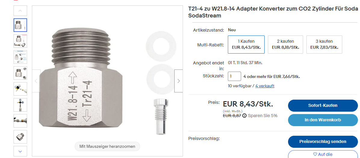

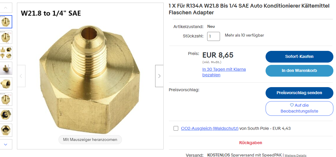

Die Adapter gibts bei Ebay:
https://www.ebay.de/itm/403883410324?_trkparms=amclksrc%3DITM%26aid%3D1110006%26algo%3DHOMESPLICE.SIM%26ao%3D1%26asc%3D20220920135554%26meid%3Dcb0caaee4f74427fb87386ab82032b84%26pid%3D101197%26rk%3D1%26rkt%3D12%26sd%3D185100662134%26itm%3D403883410324%26pmt%3D1%26noa%3D0%26pg%3D2047675%26algv%3DSimplAMLv9PairwiseWebMskuAspectsV202110NoVariantSeedKnnRecallV1%26brand%3DMarkenlos&_trksid=p2047675.c101197.m1850&amdata=cksum%3A403883410324cb0caaee4f74427fb87386ab82032b84%7Cenc%3AAQAHAAABIK6kjqEQMYM5Aq%252BOhcaIlwco9wYktoCXAP3D6Fo7POUdlJK1eqFqv5Y7huO6nLq7hjqYjs5sEMudJpf20WlRkR4rDC%252F3hpi290hQAZ3oT3ci6nzlNWp44Ot28puEaYMo6%252BdtBqyoOroKbz%252FoVOy5nT9ggStrJODKvBrOhFoiiTmmpYmxQ194jp%252BD%252B0ekE8ueua2vtZImb2PrfgChyMC4rlOGhIUrWyUpPLH0ENjqfcqIS%252Fy9lrJ7ivCZgIjUbaUIIuLZByzK8H1VeUHHjyEJIIlmVvueO%252BWEh2A5LiZBavV2om8vihZxLwGxH005y9BCg%252F6yA29ErLCR20jP8uKMXNTaC2OuFb6ubUYQEnp%252BPts5MLps8OiOH%252B21rpVc3p0nKw%253D%253D%7Campid%3APL_CLK%7Cclp%3A2047675
https://www.ebay.de/itm/304571720919?_trkparms=amclksrc%3DITM%26aid%3D1110018%26algo%3DHOMESPLICE.COMPLISTINGS%26ao%3D1%26asc%3D20220920135752%26meid%3Df0af884f08624787b4f4f1f78512e846%26pid%3D101198%26rk%3D1%26rkt%3D12%26sd%3D313610603489%26itm%3D304571720919%26pmt%3D1%26noa%3D0%26pg%3D2047675%26algv%3DItemStripV101HighAdFee&_trksid=p2047675.c101198.m1985&amdata=cksum%3A304571720919f0af884f08624787b4f4f1f78512e846%7Cenc%3AAQAHAAAA8C6VSE2uGkOxRbBlxpADtEthxikUiTIIBAHOunx1ou2ukgWAOl%252F9RtSxLeEsnQ%252FgHGEgpDgJwjWzaFvTTGAmrneBqNOobBl%252F8BWd%252FbgqW9iiuCgqMrmhktnRzilyDmhObw6ZjvzCaG420HTloZIKEJzuOrc7q6eLQj07od7%252FDyR7yFzimuozQo4Rc6I45oe6p%252BT7H7bfn7Ld5an3jNpo%252FgE59BIDWscutK56082RGHeD3L8hCR8RkKNoVd0PV3OdSZ28NFmR2vHnU4y7kg6bB15%252B4y64R1Gmoa9i85xriJOWMQXE4siQsOByqDHxcaZjcQ%253D%253D%7Campid%3APL_CLK%7Cclp%3A2047675
Habs auch nochmal als Bild angefügt, da diese Links ja nie lange halten ...

Ich schreibs mal für die Nachwelt, falls die Ebay-Links nicht mehr funktionieren:
1 Adapter von Sodastream T21-4 auf W21.8-14 Gewinde
1 Adapter von W21.8 auf 1/4 SAE
Suche bei Ebay: "sodastream w21.8" und "w21.8 sae 1/4"

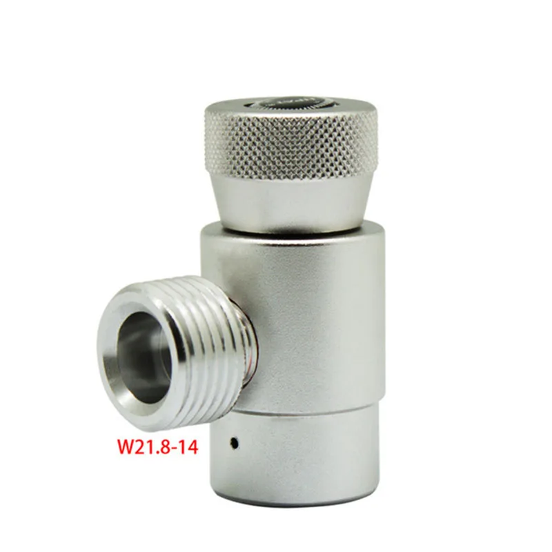

Die Idee ist auf jeden Fall interessant. Man muss nur aufpassen, nicht mehr als 40 bar auf die Anlage zu drücken. Ohne Druckminderer kann man da auch gefährlichen Mist bauen. Ist nicht Deppensicher. :wink:
Die Idee ist auf jeden Fall interessant. Man muss nur aufpassen, nicht mehr als 40 bar auf die Anlage zu drücken. Ohne Druckminderer kann man da auch gefährlichen Mist bauen. Ist nicht Deppensicher. ;)
Oder halt die Sodastrem-Flasche vorher kühlen.
Bei 0° C hat CO2 ca. 35 bar.
Frisch aus dem Eisschrank ist man (je nach eingestellter Kühltemperatur) bei ca. 30 bar. Das wäre ja ein guter Wert zur Druckprüfung?! :problem:
Aber ich denke mal, da sollte man dann noch ein Ventil zwischen schalten, welches man langsam öffnen kann?
Den Druck von 30 bar mit einem Schlag (so wäre es ja mit o.g. Adaptern) auf das System zu geben, wäre vermutl. nicht so gut, oder?
Auch würde ich dann vor dem Evakuieren das System erstmal eine Weile (druckfrei) offen lassen, bevor ich die Vakuumpumpe anschliesse.
Ein Grossteil des CO2 sollte dann mit der Erwärmung ohne Druck schon einmal vergasen und abziehen, und die abgekühlten Leitungen kommen wieder auf Normaltemperatur.
P.S.: Diese einfachen Adapter Sodastream (TR21-4) -> W21.8 sind übrigens auch nicht so ganz ohne:
Leicht falsch eingestellter Dorn (der das Ventil der Flasche öffnet), und beim Auschrauben haut der Druck die Silikondichtung durch, und man hat schnell die ganze CO2-Flasche leer.
Besser ist sowas: https://de.aliexpress.com/item/1005003016047964.html?spm=a2g0o.detail.1000014.18.48074a60mBdwAW&gps-id=pcDetailBottomMoreOtherSeller&scm=1007.40050.281175.0&scm_id=1007.40050.281175.0&scm-url=1007.40050.281175.0&pvid=7d5597b6-e4e5-4ff6-90df-683a9acb194b&_t=gps-id:pcDetailBottomMoreOtherSeller,scm-url:1007.40050.281175.0,pvid:7d5597b6-e4e5-4ff6-90df-683a9acb194b,tpp_buckets:668%232846%238107%231934&pdp_ext_f=%7B%22sku_id%22%3A%2212000023242925211%22%2C%22sceneId%22%3A%2230050%22%7D&pdp_npi=2%40dis%21EUR%2119.51%2114.63%21%21%21%21%21%400b0a23a716648041654121185e1aad%2112000023242925211%21rec , wo man den Druck erst nach dem Aufschrauben frei gibt.

Flasche deutlich runterkühlen finde ich eine gute Idee. Vielleicht sogar in den Tiefkühler legen. 20 bar reichen erstmal, nach 30 Minuten kann man nochmal höher gehen, in der Zwischenzeit liefert die Flasche auch schon mehr Druck.
Dein alternativer Adapter mit Ventildrücker ist super. Hab den auch bei Ebay gefunden:
