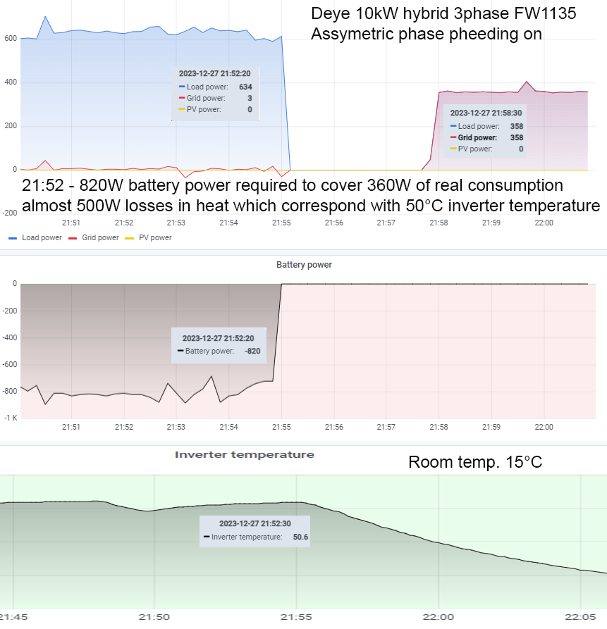

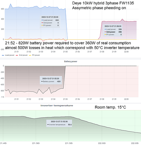

I follow this forum and I measure self-consumption of deye in HomeAssisstant by its internal sensors, it has some limitations but it is for another post.... Now I am trying to find the consumption in different scenarios. As said before and I can confirm this:
  • Idle consumption (no PV, no battery) is around 12W
  • No battery, PV ON is 100W+
  • Battery connected without use 110W+ (discharged on preset value waiting on blackout or charging)
  • Battery connected and used - lets see
I have found probably the worst case scenario and that is discharging the battery on few hunder watts of real consumption. Details on the picture. Everyday I turn ON/OFF the battery to save power and check differences in SolarAssistant. There is not many occasions in winter due to no sun and no charging. Yesterday I turned off the batterry in operation range 35%-100% for discharging. These are the results:
Reading can be wrong. I encourage you to test. I am still trying to verify if it is actually correct. I measure (PV + Battery power) minus inverter LD values. In that particular hour showed only 250W consumption so I am bit supprised what is wrong that the real values are doubled. I have to double check everything and turn off assymmetric phase feeding.
EDIT:02.01.2023 - I am trying to simulate again that behaviour without any success. Usuall consumption with battery running and discharging is usually 200-300W with 400-1000W load.
After upgrade on C042 and 1144, consumption with battery connected and sitting on SOD is around 130W based on internal sensors.
EDIT: Consumption edited to 110W by longer measurements.

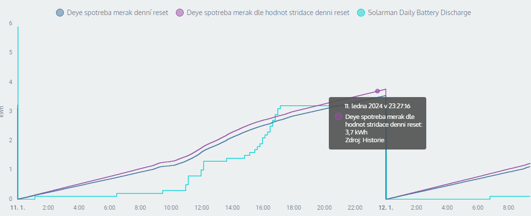

This is daily consumption of the inverter without turning off the battery. As you can see we could turn it on at 8:00 and turn it off at approx 17:00. Which could save us 15hours multiplied by 110W = 1,65kWh. Total consumption is almost 4kWh which involves DC/AC losses from discharging the battery and some losses from PV panels but I do not meassure DC on panels so I dont know if invertor shows AC or DC values. Daily PV generation was 12,8kWh....so almost 30% of energy was wasted. With turning off the battery it would be 18%.
On the picture there are two measurements, Purple is calculated consumption from inverters battery values and blue is from BMS values. If you think why it is different in the morging and evening it is because inverter still shows some power (even when battery is off in other days). But inverter is more precise regarding lower currents when battery is connected. BMS only measures power from 0,5A above.
DeepL translation - no guarantees
Dies ist der tägliche Verbrauch des Wechselrichters, ohne dass die Batterie abgeschaltet wird. Wie Sie sehen können, könnten wir ihn um 8:00 Uhr einschalten und um ca. 17:00 Uhr ausschalten. Damit könnten wir 15 Stunden multipliziert mit 110W = 1,65kWh sparen. Der Gesamtverbrauch beträgt fast 4kWh, was die DC/AC-Verluste durch die Entladung der Batterie und einige Verluste durch die PV-Paneele einschließt, aber ich messe den DC-Wert der Paneele nicht, so dass ich nicht weiß, ob der Wechselrichter AC- oder DC-Werte anzeigt. Die tägliche PV-Erzeugung betrug 12,8kWh.... also wurden fast 30% der Energie verschwendet. Bei ausgeschalteter Batterie wären es 18%.
Auf dem Bild sind zwei Messungen zu sehen, lila ist der berechnete Verbrauch aus den Batteriewerten des Wechselrichters und blau ist der aus den BMS-Werten. Der Unterschied zwischen Morgens und Abends liegt darin, dass der Wechselrichter immer noch etwas Strom anzeigt (auch wenn die Batterie ausgeschaltet ist). Aber der Wechselrichter ist präziser in Bezug auf niedrigere Ströme, wenn die Batterie angeschlossen ist. BMS misst die Leistung nur ab 0,5A.

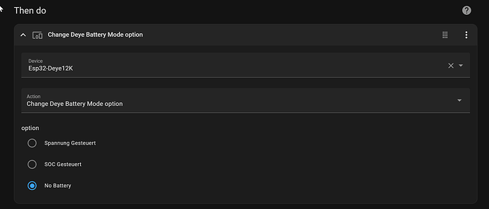

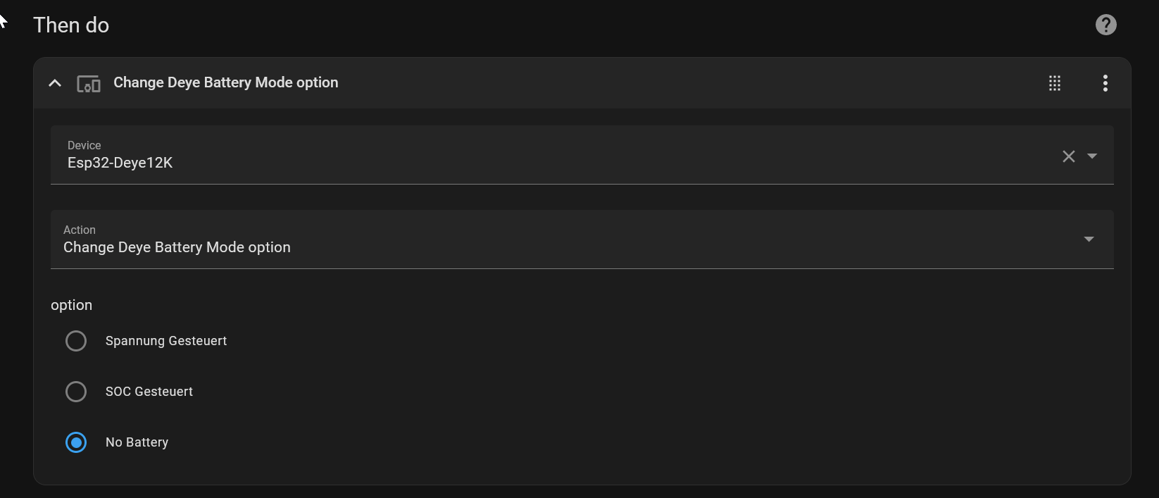

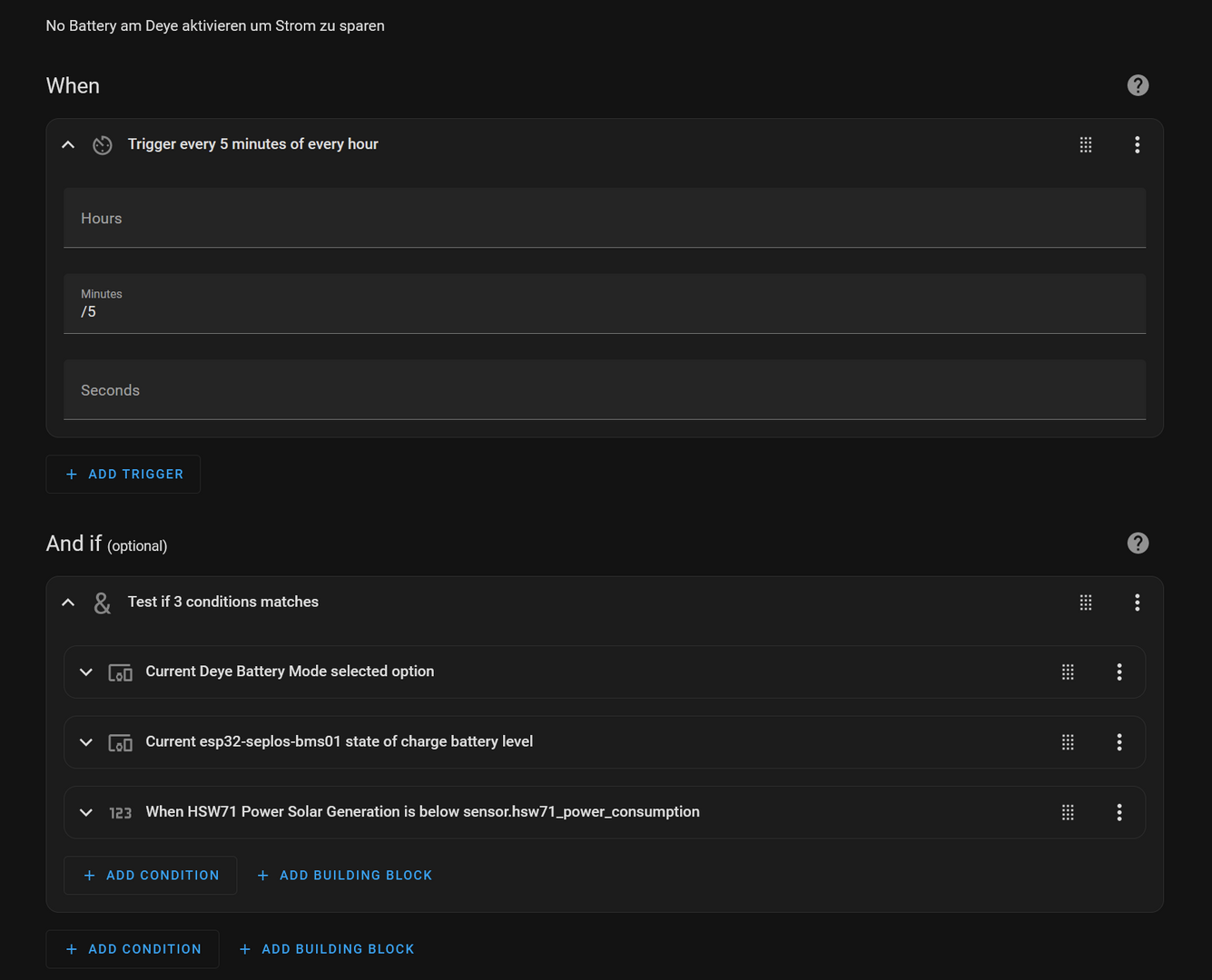

Ich hab deine Definitionen zum Batterie Modus und Typ in ESPHome und Home Assitant übernommen, das hat soweit geklappt. Ich beschäftige mich aber erst sein 2 Tagen mit Home Assistant und nur wenig länger mit ESPHome, d.h. meine Möglichkeiten sind limitiert.
Du hast auch davon geschrieben, Automationen damit zu machen. Kannst du erzählen, wie du es umgesetzt hast?
Viele Grüße
Gisbert
@gisbert einfach was zusammengestrickt unter Automation....
einfach etwas kreativ werden, wann man ein und ausschalten möchte.

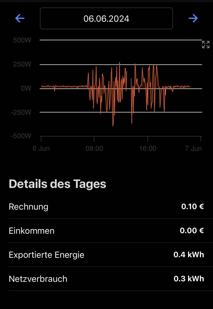

So, die ersten 24 Stunden am Netz sind um, heute sogar einwenig geladen. Leider noch Netz-parallel. Da die PV Module nicht drauf sind. Da muss der Deye sich mit dem Balkonkraftwerk begnügen. Was mir aufgefallen ist, das der Nachts ziemlich gut sich bei den 20 Watt einpendelt (tiefer lässt sich zwar einstellen, geht dann aber nach Paar Minuten wieder auf 20W zurüc). Aber am Tag Zappelt der sich eine zurecht, da darf mann nicht hinschauen...
Ist es bei euch auch so, dass der so schwingt?
Der hat Heute 0,4kW eingespeist und 0,3kW gezogen, obwohl auf 0 Export steht..
(Habe den Iammeeter WEM3080t noch als Zähler dazwischen) Der kann saldieren im Gegensatz zu Shelly 3em PRO
