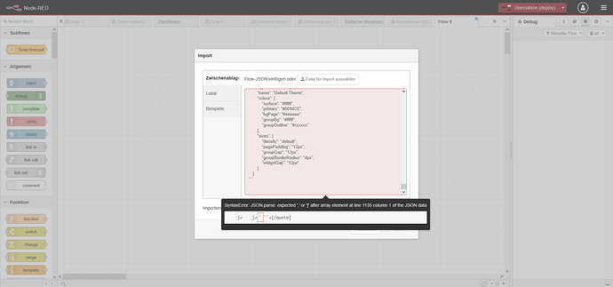

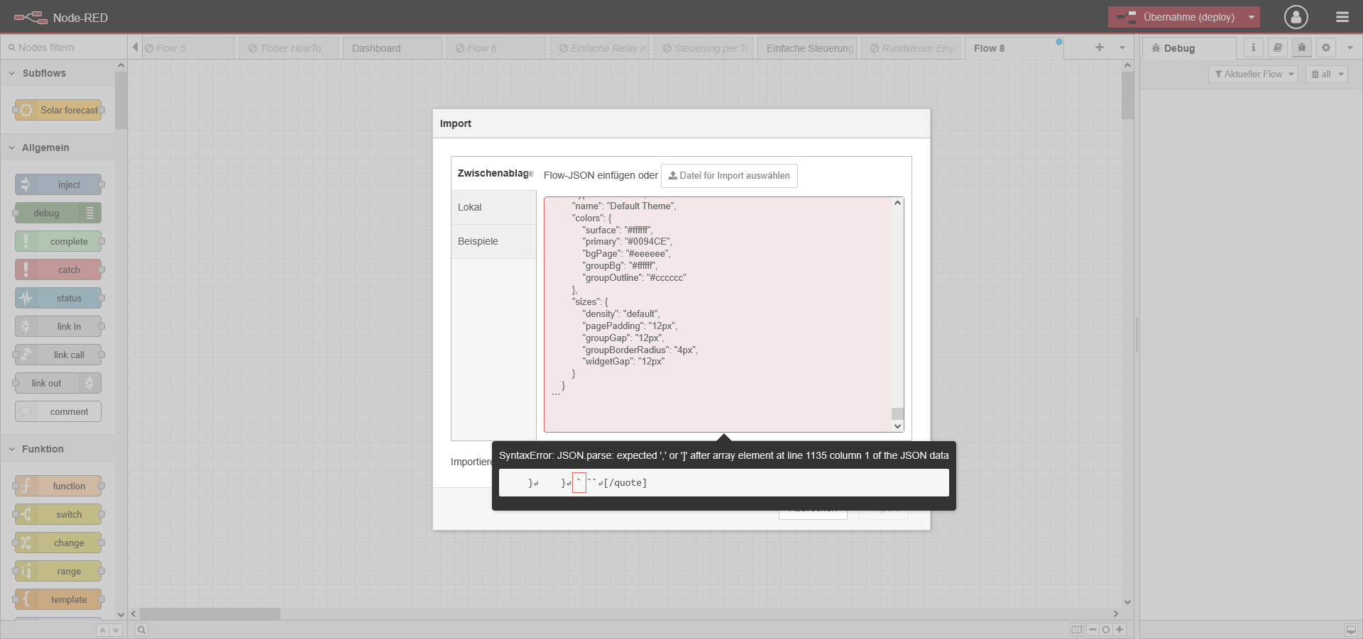

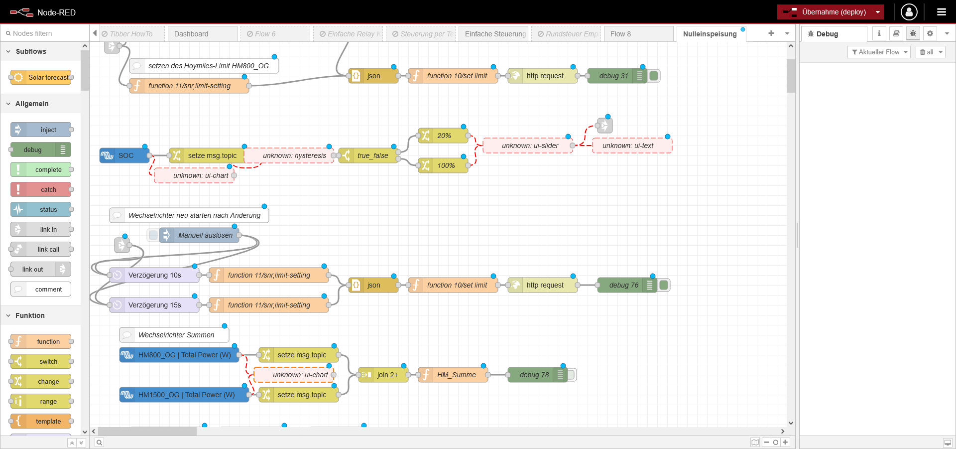

Hallo, hier ist die Lösung per NodeRed http request:

        "id": "0ba9ccc7df75dd77",
        "type": "function",
        "z": "550ff65f05ef0bf3",
        "name": "function 10/set limit",
        "func": "//\nvar inData = msg.payload;\nvar outData = inData.replace('[', '').replace(']', '');\n\nvar URLopenDTU = \"http://192.168.XXX.XXX\";\n\nvar NewMsg={};\nNewMsg.method = \"POST\";\nNewMsg.url = URLopenDTU + '/api/limit/config';\n\n\nNewMsg.headers = {\n    'Authorization': 'Basic '+(Buffer.from('Benutzer:PW')).toString('base64'),\n    \"Content-Type\": \"application/x-www-form-urlencoded\"\n}\n\nNewMsg.payload = 'data=' + outData;\n\n//.payload = {serial:114XXXXXX, limit_type:1, limit_value:88\n\nreturn NewMsg;",
        "outputs": 1,
        "timeout": 0,
        "noerr": 0,
        "initialize": "",
        "finalize": "",
        "libs": [],
        "x": 730,
        "y": 260,
        "wires": [
                "09798895a1313e08"
        "id": "09798895a1313e08",
        "type": "http request",
        "name": "",
        "method": "use",
        "ret": "txt",
        "paytoqs": "ignore",
        "url": "",
        "tls": "",
        "persist": false,
        "proxy": "",
        "insecureHTTPParser": false,
        "authType": "",
        "senderr": false,
        "headers": [],
        "x": 910,
        "y": 260,
        "wires": [
                "18d6074ca5c3f9c3"
        "id": "18d6074ca5c3f9c3",
        "type": "debug",
        "name": "debug 31",
        "active": true,
        "tosidebar": true,
        "console": false,
        "tostatus": false,
        "complete": "true",
        "targetType": "full",
        "statusVal": "",
        "statusType": "auto",
        "x": 1060,
        "y": 260,
        "wires": []
        "id": "33c63d5f3b48b97c",
        "type": "function",
        "name": "function 11/snr,limit-setting",
        "func": "var Hoymiles_SNR = \"116XXXXX\";\nvar Hoymiles_Limit = msg.payload;\n\nmsg.payload=[{serial:Hoymiles_SNR,\n            limit_type:1,\n            limit_value:Hoymiles_Limit}];\n\nreturn msg;",
        "outputs": 1,
        "timeout": 0,
        "noerr": 0,
        "initialize": "",
        "finalize": "",
        "libs": [],
        "x": 380,
        "y": 160,
        "wires": [
                "0883d2ed62bd19da"
        "id": "0883d2ed62bd19da",
        "type": "json",
        "name": "",
        "property": "payload",
        "action": "",
        "pretty": false,
        "x": 570,
        "y": 260,
        "wires": [
                "0ba9ccc7df75dd77"
        "id": "dc4dc2cdb362c02b",
        "type": "comment",
        "name": "setzen des Hoymiles-Limit über die openDTU",
        "info": "",
        "x": 250,
        "y": 40,
        "wires": []

Es beinhaltet eine Hysterese und ein Dashboard um das Limit zu ändern. Das wird in deiner Installation fehlen und muss nachinstalliert oder entfernt werden. Die IP der DTU, Seriennummern und Benutzerdaten müssen geändert werden.
Liebe Grüße
Marcel
Hallo, wenn ich das versuche zu importieren, dann kommt der fehler:
davon stand auch zuanfang etwas mit qote und so das hab ich gelöscht, dann kam dieser, aber wo ist reihe 1135??
Benutzt das kopier Symbol im Codeblock. Dann sollte es klappen, habs selbst ausprobiert.
mit kopieren geht, aber nu hat er einpaar funktionen die er nicht kennt, kannst mir sagen was ich da nach installieren muß?
wenn er die nicht kennt, nimmt er alle flows off
man, lesen muss man können, grins
mit was hast du die hysterese geschrieben?
hab es soweit zum laufen bekommen.
welches value muss ich angeben statt hoymiles,limit wenn ich ihn ausschalten will?
wofür dient der neustart nach änderung?
solang der an ist geht er nach ablauf der zeit immer wieder auf 100%
wenn ich ihn aus mach, bleibt er bei 0%
Für die Hysterese musst du das node-red-contrib-hysteresis installieren. Dann erkennt er den Node automatisch.
Ausschalten kann ich dir nicht genau sagen. Vielleicht einfach nur das Limit runter setzen.
Ich hatte den Eindruck, dass er nur mit einem Neustart die Änderung von dem Limit übernimmt. Kannst ja mal ohne testen.
hallo Marpi, dein flow funzt nach ein paar anpassungen wunder bar,
