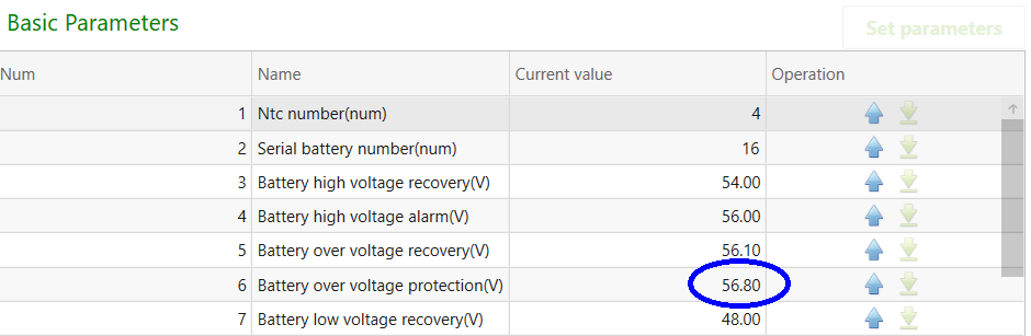

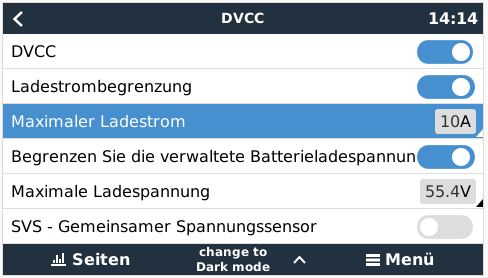

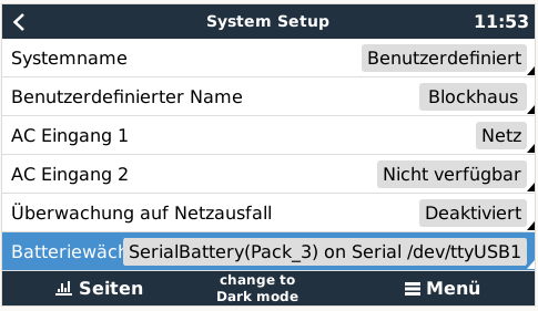

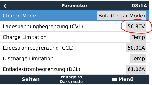

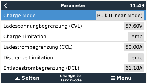

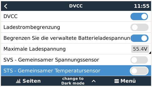

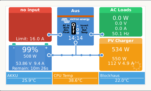

Hello everybody,
since two days I´m testing the dbu…s-serialbattery driver in use with a SEPLOS V3 BMS. Before that, more than one of a year there was a JK BMS connected and used successfully. With SEPLOS V3 charging, discharging and so on wokrs fine but there is one issue with CVL value in remote console. In config.ini I set the following values (which worked fine with the last used JK BMS):
MAX_CELL_VOLTAGE = 3.460
FLOAT_CELL_VOLTAGE = 3.375
Although the max_cell_voltage is set to 16 x 3.46 = 55,36V, the venus remote console shows a value of 57.6V which means that die parameter in config.ini might be ignored? I tried to find out why this happened, but I can´t find the reason. I would be very happy about any help, tanks.
