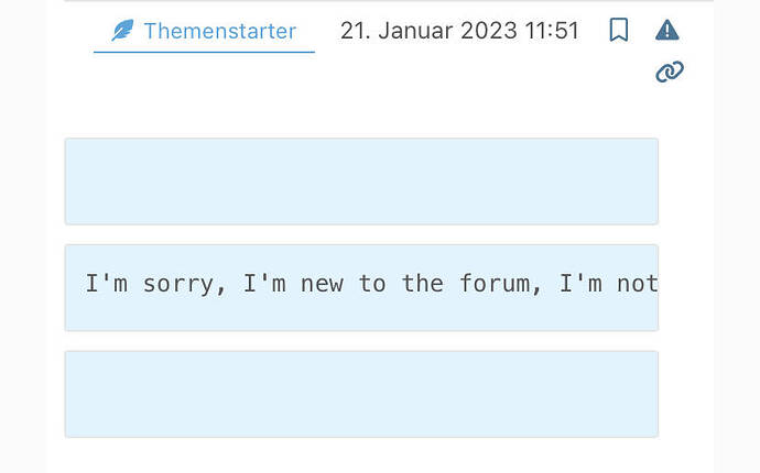

This is what I see on my smartphone when you paste something different than plain text!
