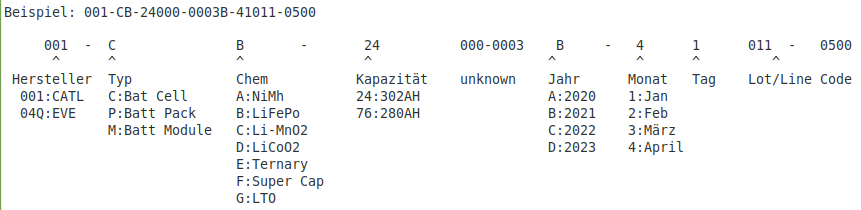

Update how to decode Battery QR Code (copied from Gobal Power website)
Jetzt auch mit Handycam decodierbar!
How To Use Battery QR Decoder
1. Where to Find QR Code
All brand new LiFePO4 cells have metal QR Code (Data Matrix) on the cell body somewhere around poles. For example:
Metal QR Plate of CATL 302Ah Cell
2. How to Type QR Code
There are code on the metal QR plate. Valid code has to be 24 bits (or 19 bits for recycled cells), which is usually splited into two parts. These two parts have to be combined in right order. Some cells may have other letters which are not a part of code, these letters should be ignored. For example:
Code of CATL 302Ah Cell: Combine part 1 (001cb2400000) and part 2 (03b3c0221953) to get 24 bits code 001cb240000003b3c0221953
Code of EVE 280K Cells: Combine part 1 (04qcb76836300j) and part 2 (bc40000903) to get 24 bits code 04qcb76836300jbc40000903
3. How to Check If Your Code is Right
The code length must be 24 or 19.
The 4th letter of the code is for product type. It must be:
C for battery cell
P for battery pack
M for battery module
The 4th letter must not be letter other than C, P, or M.
For Example:
A765101015 (Wrong Code)
jbc4000090304qcb76836300 (Wrong code order, 4th letter is 4)
04qcb76836300jbc40000903 (right code, 4th letter is c)
4. What Cells Are Supported
The decoder algorithm is based on "Battery Coding Standards" issued by China Goverment. Any codes following this standard can be decoded by Gobel Power Battery QR Decoder, such as LiFePO4, Ternary, LTO cells, modules and packs.
By now, all codes' production date, product type, battery type and voltage (cells only) information can be decoded. Manufacturer, capacity information of EVE cells and some CATL cells can be decoded.

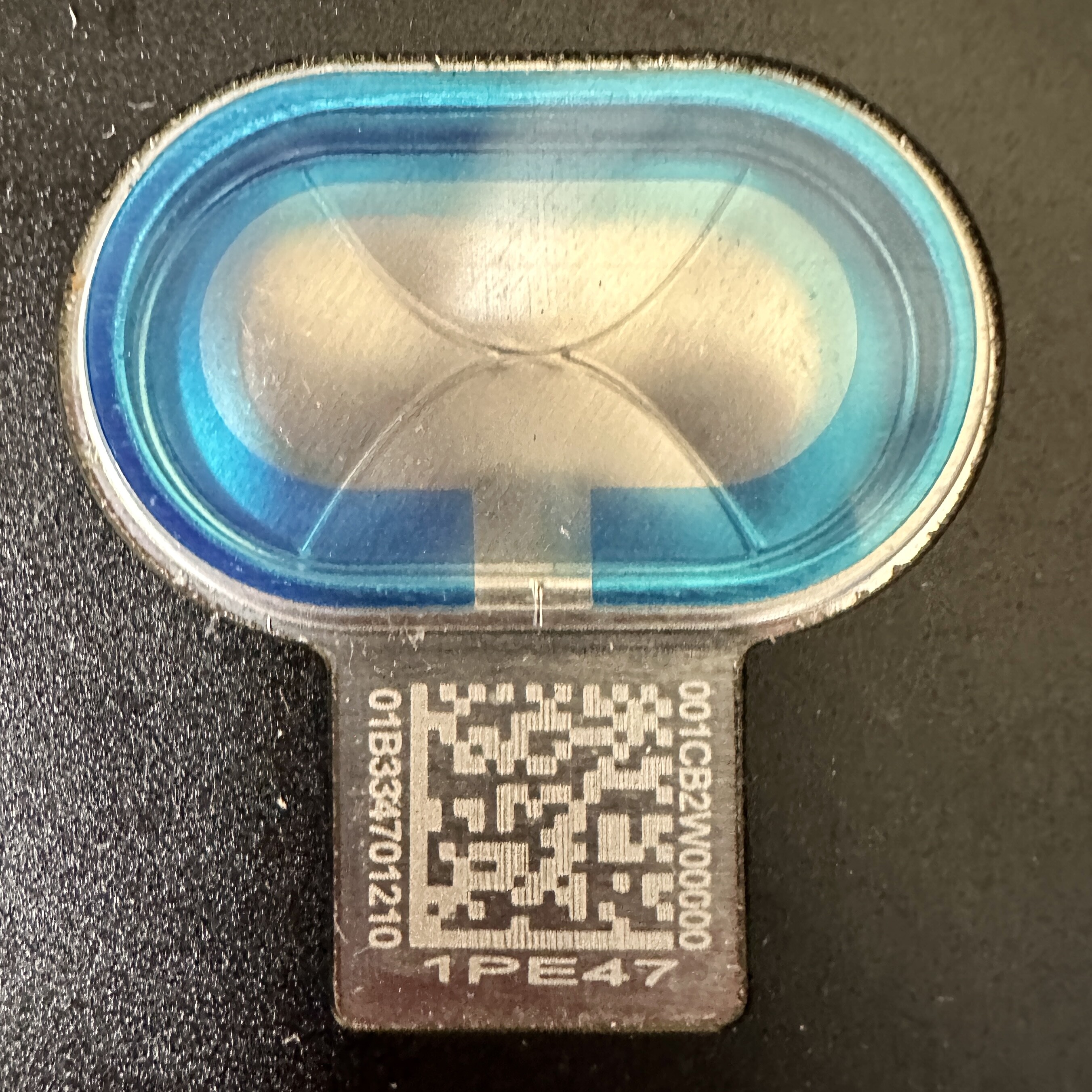

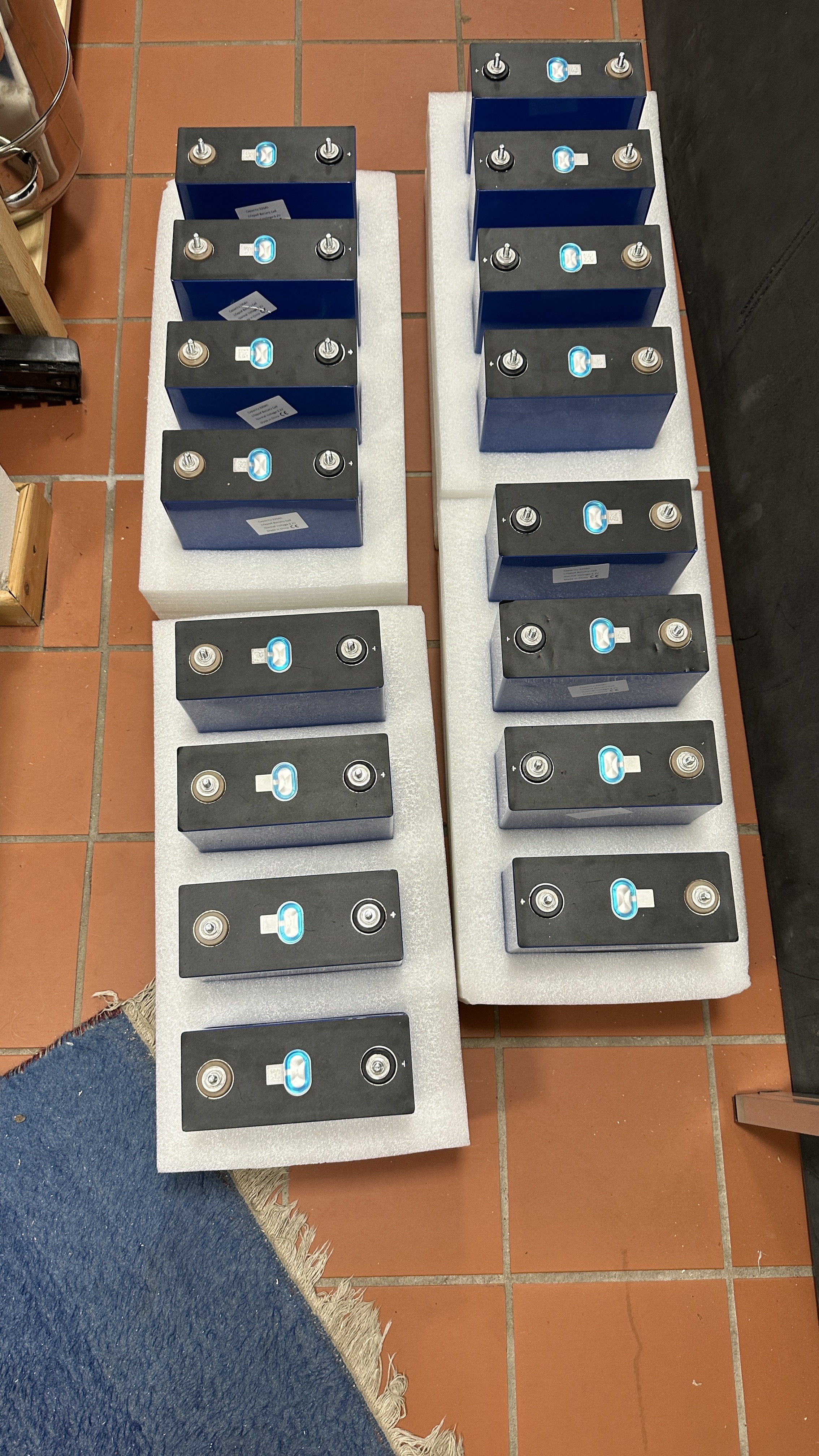

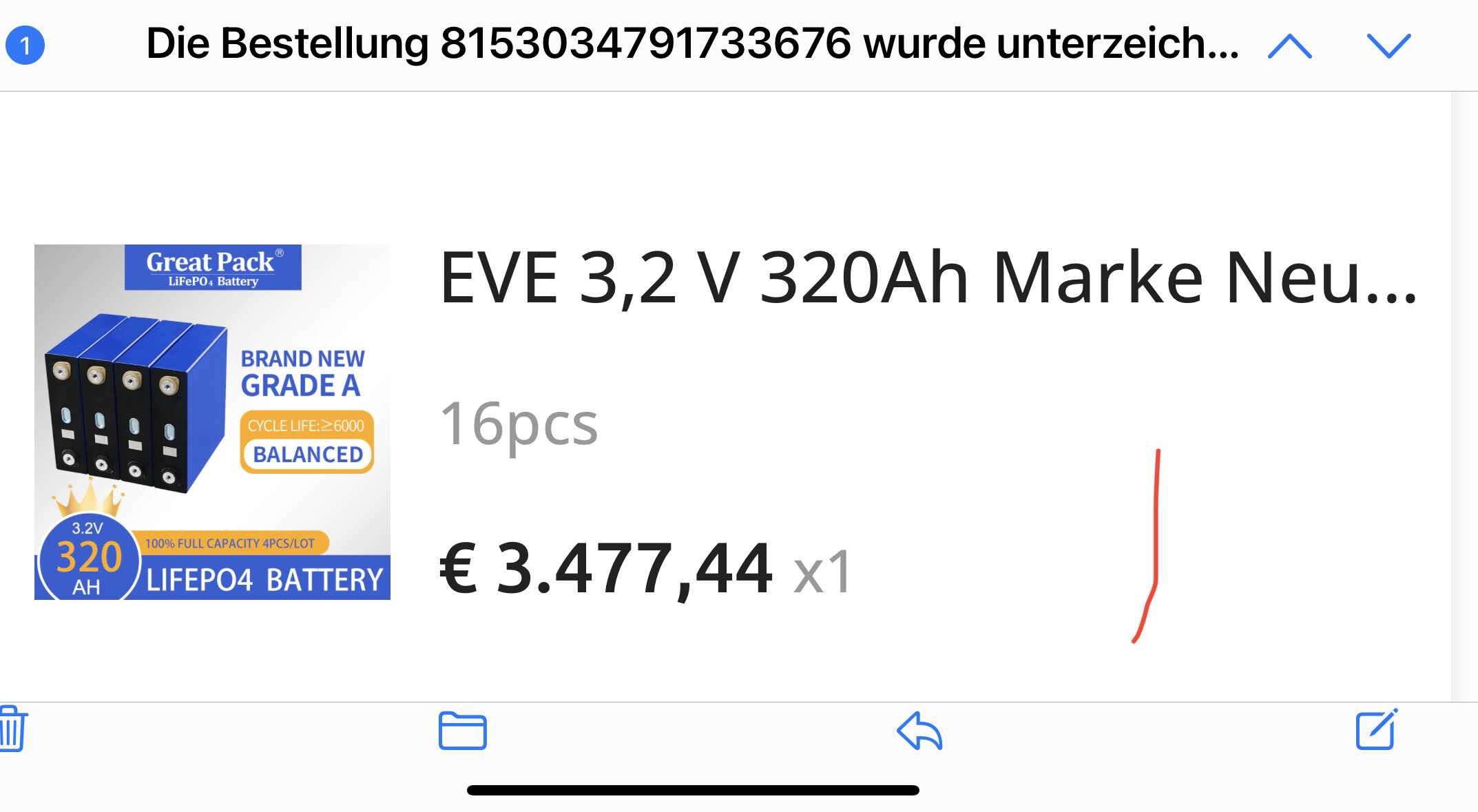

Ich habe im Juli 22 vom Shop Great Pack 16x EVE 320Ah bestellt und vor drei Tagen die Akkus bekommen. Nun habe ich den Code bei Basen Energie Basenpower.com
https://www.basenpower.com/QR-DECODER/ oder auch bei Gobel Power eingegeben.
Es stellte sich heraus, das es statt EVE 320Ah Cells wohl CATL 280Ah Zellen sind.
Beispiel: 001CB2W0000001B3N4709158
Code Check...
Code: 001-CB-2W-0000001-B3N-4709158
Code seems right.
Code length is right.
Manufacturer:CATL
Product Type:Battery Cell
Battery Type:LiFePO4
Nominal Capacity:280Ah
Nominal Voltage:3.2V
Production Date:22/Mar/2021
Manufacturer Website:https://www.catl.com

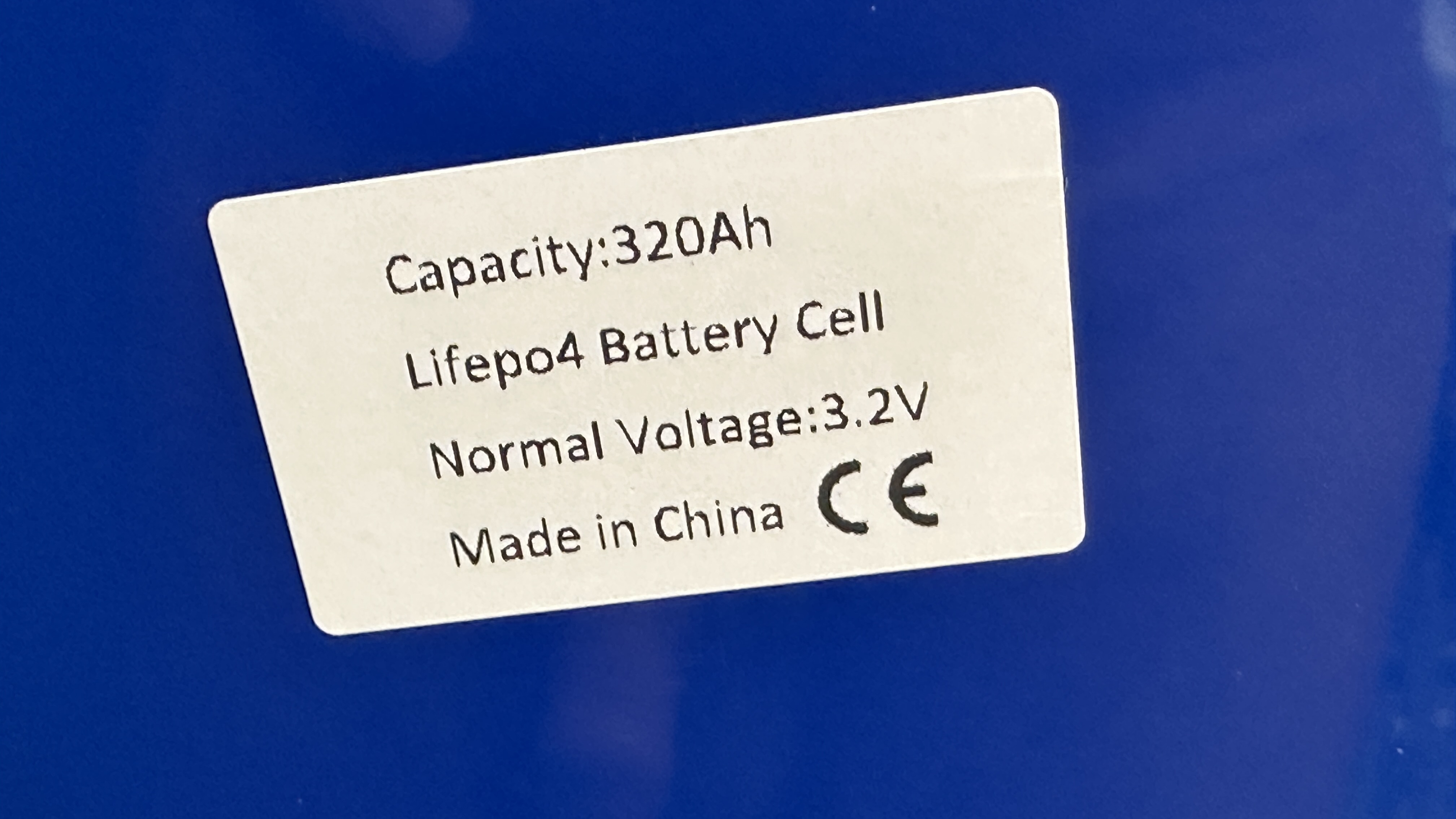

Auf den Zellen ist ein Etikett 320Ah drauf
Der Händler meinte ich solle die Kapazität messen. Er würde mir keine 280Ah Akkus verkauft haben. Auf den Hinweis, das es CATL Zellen sind, meinet er das die Kunden eher CATL als EVE Zellen haben wollten.
Ich gehe davon aus, das der Codechek keine Fehlinformationen ausgibt oder laufen die 320Ah unter der Code-Bezeichnung 280Ah?
Ich werde einen Streitfall eröffnen oder wie seht ihr das?
Mit freundlichen Grüßen Matthias Voß
ch würde auch ein Case aufmachen- aber nicht um die Zellen zurück zu schicken sondern um einen anständigen Anteil erstattet zu bekommen.
Die Rücksendung der Zellen würde den Lieferanten ja auch ordentlich was kosten, und eine Ersatzlieferung stünde dann ja immer noch aus. Da kommen locker ein paar hundert Dollar zusammen die du raushandeln könntest.
CATL stellt übrigens gar keine 320Ah Zellen her sondern lediglich 302 Ah Zellen. Lediglich in der endprüfung werden die Zellen nach gemessener Kapazität sortiert.
Wenn dein Zellen i.o. sind, also Kapazität mindestens
300Ah und neueren herstelldatums sind macht’s keinen unterschied ob du CATL ode EVE Zellen hast.
……. CATL trickst wenigstens nicht mit dem barcode rum um 2. oder 3. Wahl Zellen noch zu verticken….
