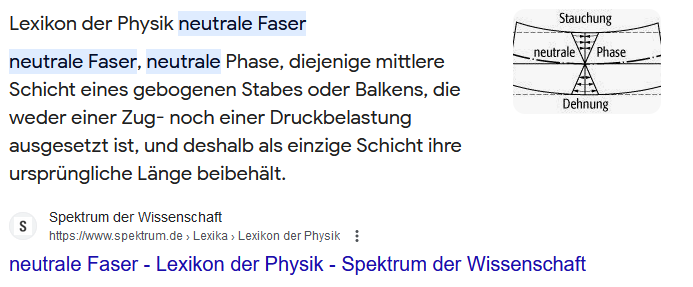

Die Zellen in einem Glas/Glas Module sind (wenn man einem Begriff aus der Physik verwendet) in der Neutralen Faser
erleben also bei Biegebelastungen des Moduls keine Zug oder Schubspannungen... besser kann an die kaum behandeln.

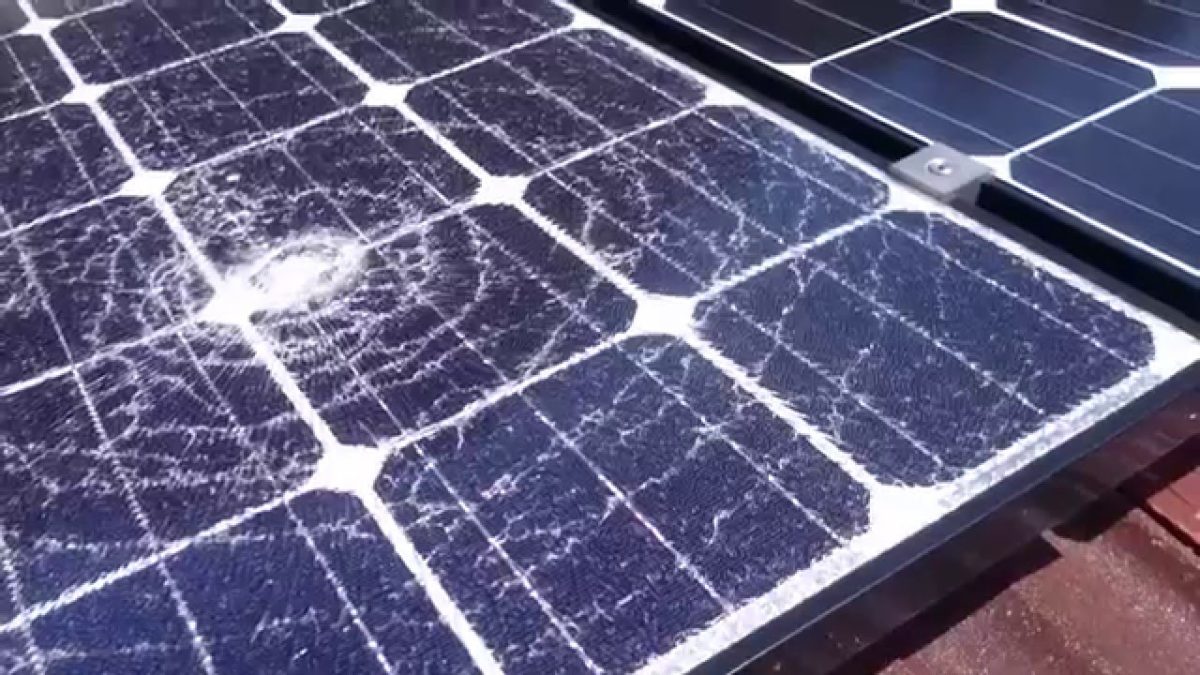

Auch gibt es in letzter Zeit wohl Berichte ueber "spontanen" Bruch bei Glas/Glas Modulen.
und auch: Solar Glass Durability and Failure Modes — RETC, LLC
RETC: Why do you think this failure mode is increasing now?
TB: Solar glass is thinner today than it was in the past. Because the glass is thinner, it is not fully tempered. According to glass experts like Mike Pilliod from Central Tension, who spoke at NREL’s 2024 PV Module Reliability Workshop, any manufacturer can temper glass that is 3 mm [0.12 in.] or thicker because it is relatively easy to get the thermal differential to build the stress profile you need. However, it is more difficult to fully temper glass below a thickness of 3 mm. If you do not have a good temper on the glass, it is relatively easier for the glass to break. In other words, as solar glass gets thinner, it takes fewer defects to cause a strength-limiting flaw in the glass
