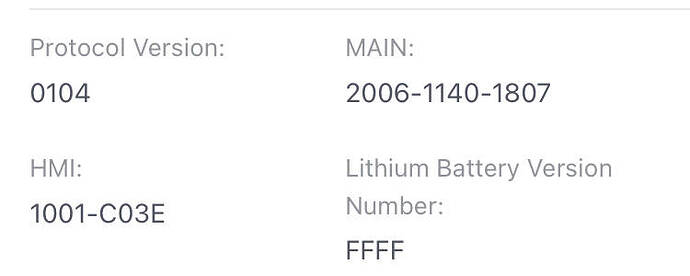

sieht fur mich eher wie ein Software Bug aus?

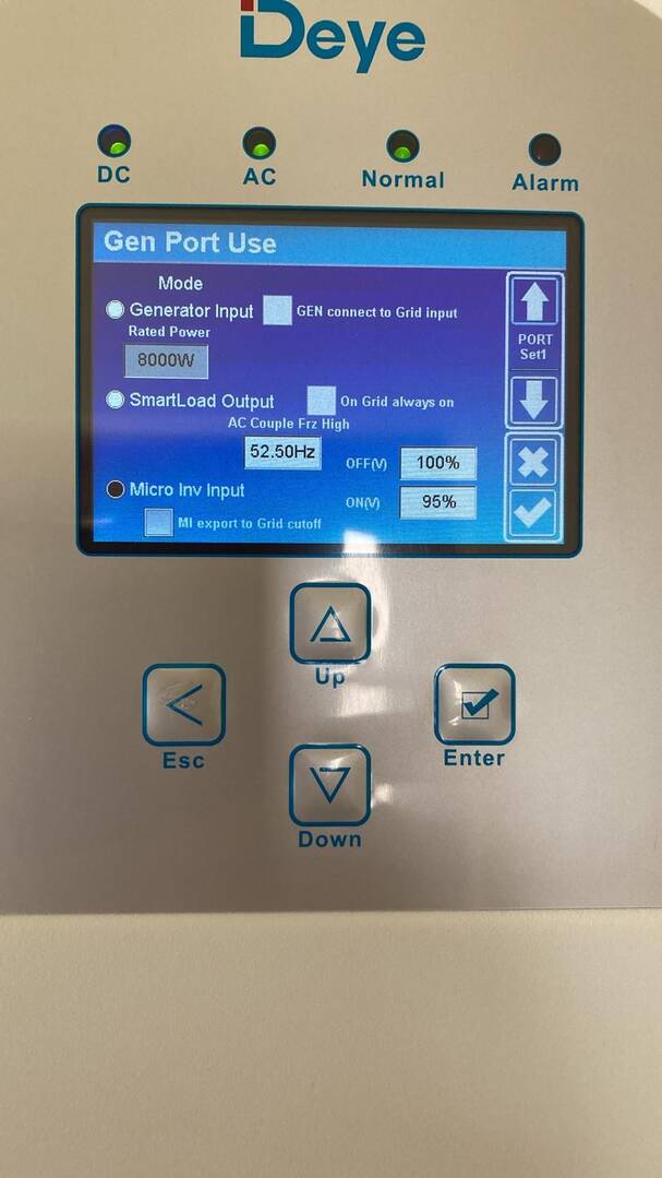

you have set 95% for ON and 100% for off. Change to 0% and 100% if you need it always ON
@deyesolar_eu
hello,
u mean 0% on and 100% off?
and yes it should always on.
i watched when he turn it off - its on Random Batterie soc 80 - 50 %. And he do it not every day - he did it 1x per month randomly for me :grimacing: make no sence to me. :crazy_face:
