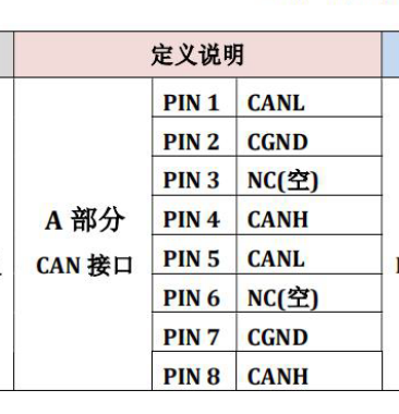

TaiCo:
Also Pin 2 Ground, Pin 4 High, Pin 5 Low

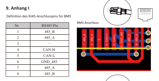

Deye:
Pin 4 High, Pin 5 Low, Pin 6 Ground
