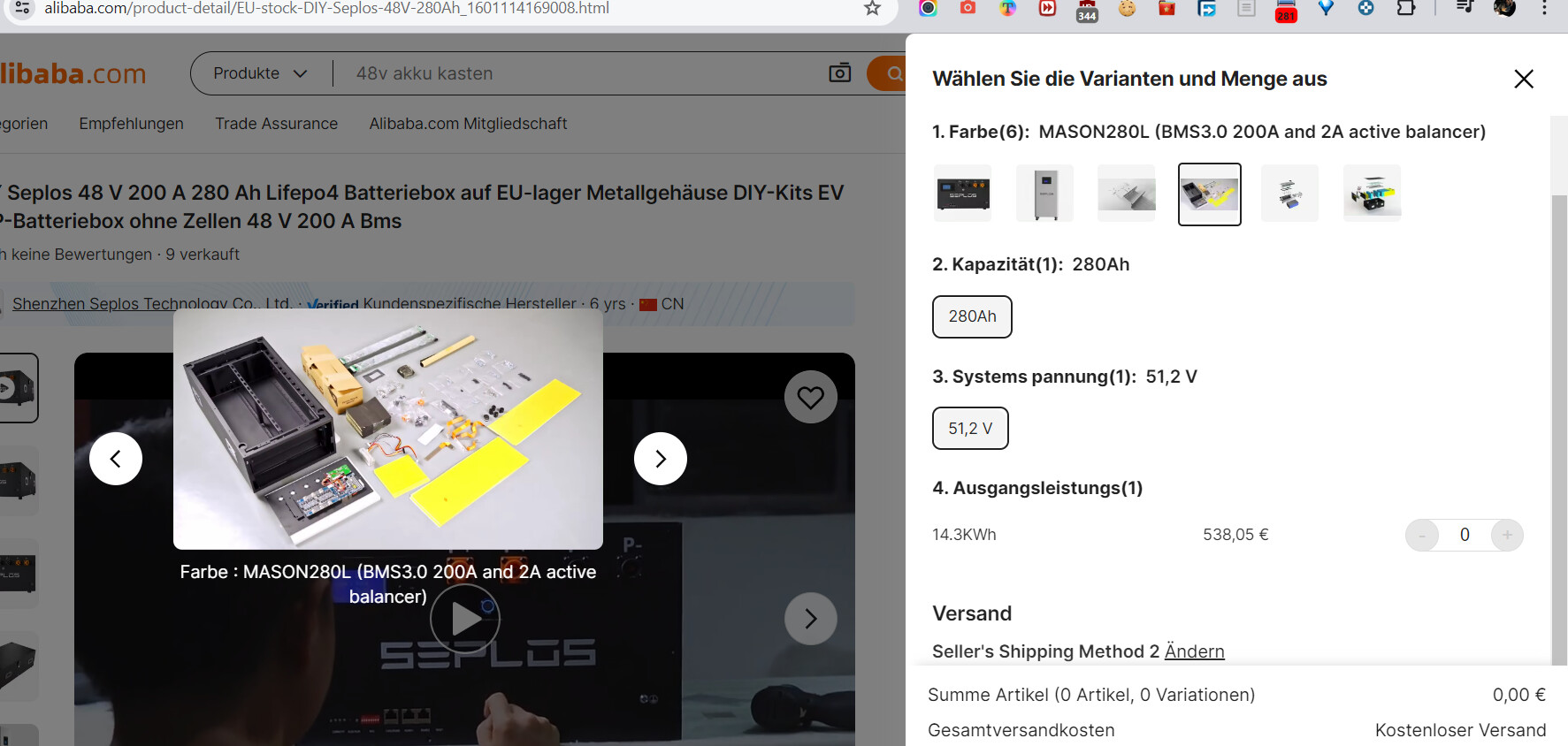

unfortunatelly no active balancer available for the rack version and therefore got an EEL with JK BMS and active balancer today.
But there is a bug in your description on your alibaba EU / german warehouse site.
I have chosen the 4 th option black rack with active balancer which is not in stock,
but the description is wrong: MASON280L (BMS3.0 200A and 2A active balancer)
